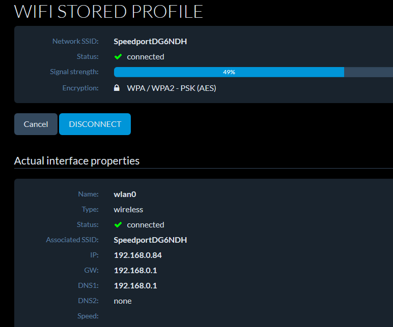

Re: Rune WiFi Only Connects To TKIP, Not AES
Postby hondagx35 » 11 Dec 2017, 21:52

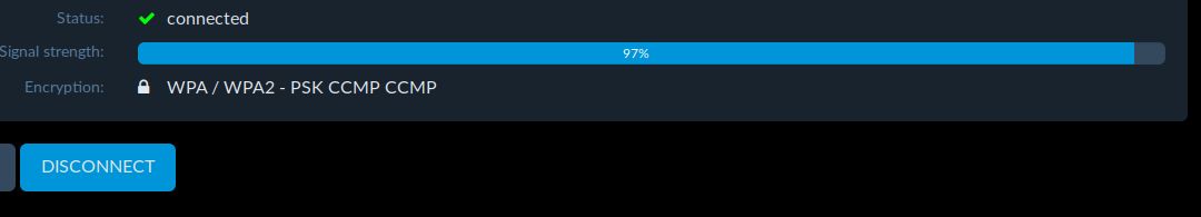

Postby R101 » 12 Dec 2017, 11:05
Thanks for the response, Frank.
Could this be something to do with my TP-Link router or the fact that my SSID is hidden? My display shows CCMP twice, rather than AES as yours does. I have only been able to connect to AES by editing the netctl file. If I enter both options CCMP TKIP, it seems to connect to either.
Postby hondagx35 » 12 Dec 2017, 11:26
