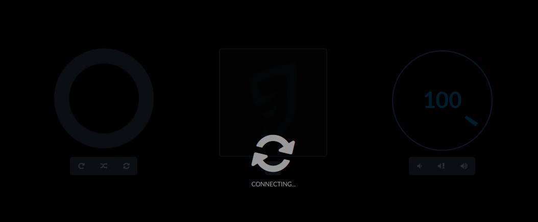

Postby nic » 11 Jul 2014, 22:13
It helped a little but it still not loading the page correctly every time . See attachment .
cheers
Nic
