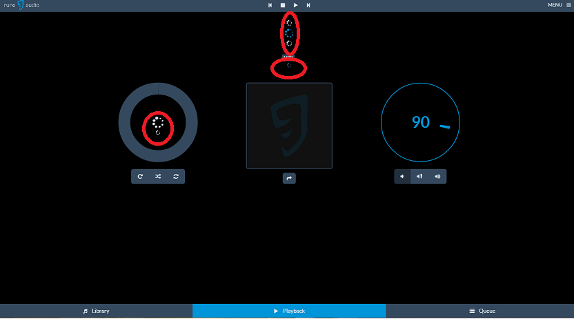

I am permanently getting a SWOD. I have re-downloaded and re-flashed the SD card a couple of times and nothing works. This happens from ALL clients (Android/Chrome/Mozilla) and all screens. (i.e if I add /dev the SWOD is also there...)
This happens the moment I change the /etc/netctl/eth0 to static or when I (eventually) get DHCP (by restarting through netctl) to work and I pick up a static ip.
I then upgraded the GUI (as per procedure) and clear the CACHE through SSH. I now do not get the SWOD, but (1) I have to manually start the eth0 (with "netctl restart eth0) and (2) get little circles in the GUI on the playback screen and (3) get no content in the queue screen, allthoug something is loaded and playing.
Here is a snapshot of the playback screen:
