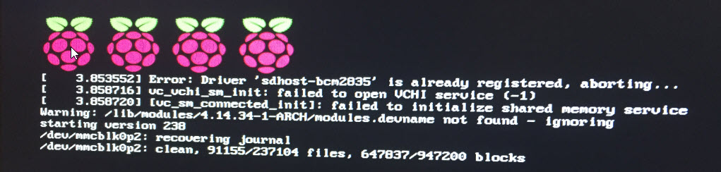

Postby robd » 18 Jan 2019, 11:50
robd
Joined: 22 Oct 2018, 21:13
Postby Colin » 18 Jan 2019, 11:58
Probably nothing ! The errors aren't fatal errors. The thing is that by default, the UI is not started on the attached display. You have to plug the Pi to the wired network, go to http://runeaudio.local/, and enable "Local browser".
(Maybe that would be a good feature that the local browser is started by default on a brand-new install if a screen is connected)
