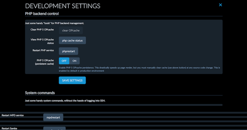

Thanks for your fast reply Janui. Another strange thing going on: before I chose to do a fresh install I had Build 7 installed and my development menu was messed up. Now I have everything how I want it again and the same thing is going on. See attachement.
I have tried to do a Git Pull on both versions in the terminal but both times it results in failure.
In 7 it was something like: no such file or directory (it was something else but can't recall it exactly)
Now it is: Updating 565826d..a4402e8
error: Your local changes to the following files would be overwritten by merge:
app/libs/runeaudio.php
app/templates/mpd.php
Please commit your changes or stash them before you merge.
Aborting
For now I am on build 9 and everything works great but it would be nice to know that I could simply update instead of performing a fresh installation each time.
Any ideas what could be wrong?

Postby janui » 28 Feb 2019, 21:29
Postby vennesch » 28 Feb 2019, 21:47
I tried your suggestion Janui.
Just uninstalled them using "uninstall_addo.sh" via terminal. Rebooted and same thing happening in development section.
I could make a screenshot but it will look the same as previously posted.
I don't get it....
Edit: also tried Rern uninstall via development section, same result
Edit 2: Solved it running "git stash" (no idea what that is :-)) before running "git pull". Updated to build 10 now and everything is working fine!
