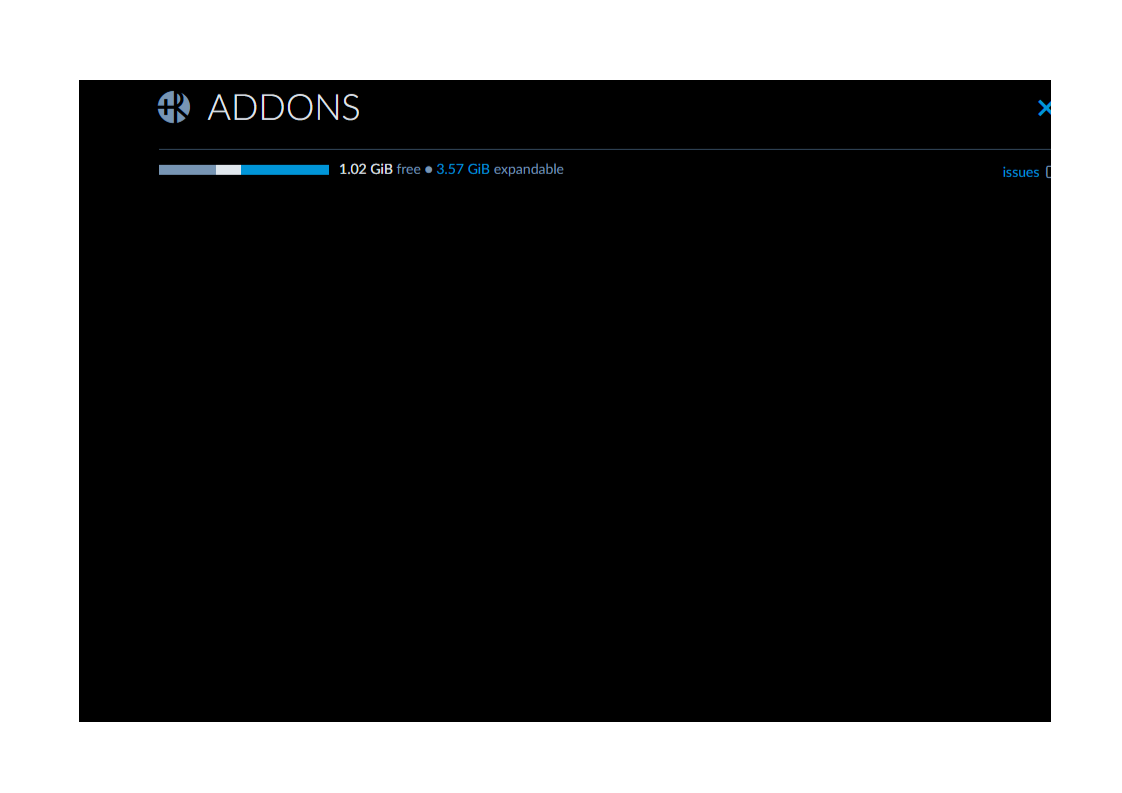

Postby Ripa » 24 Sep 2018, 07:30
im trying to get this work, update everything, also add ons
i only get this screen, can not select any
thanks

Re: RuneAudio 0.5-beta for all Raspberry Pi models
Postby janui » 24 Sep 2018, 11:07
Hi Ripa,
Thanks for your post. Please see here: runeaudio-0-5-beta-for-all-raspberry-pi-models-t6532-10.html#p25849
