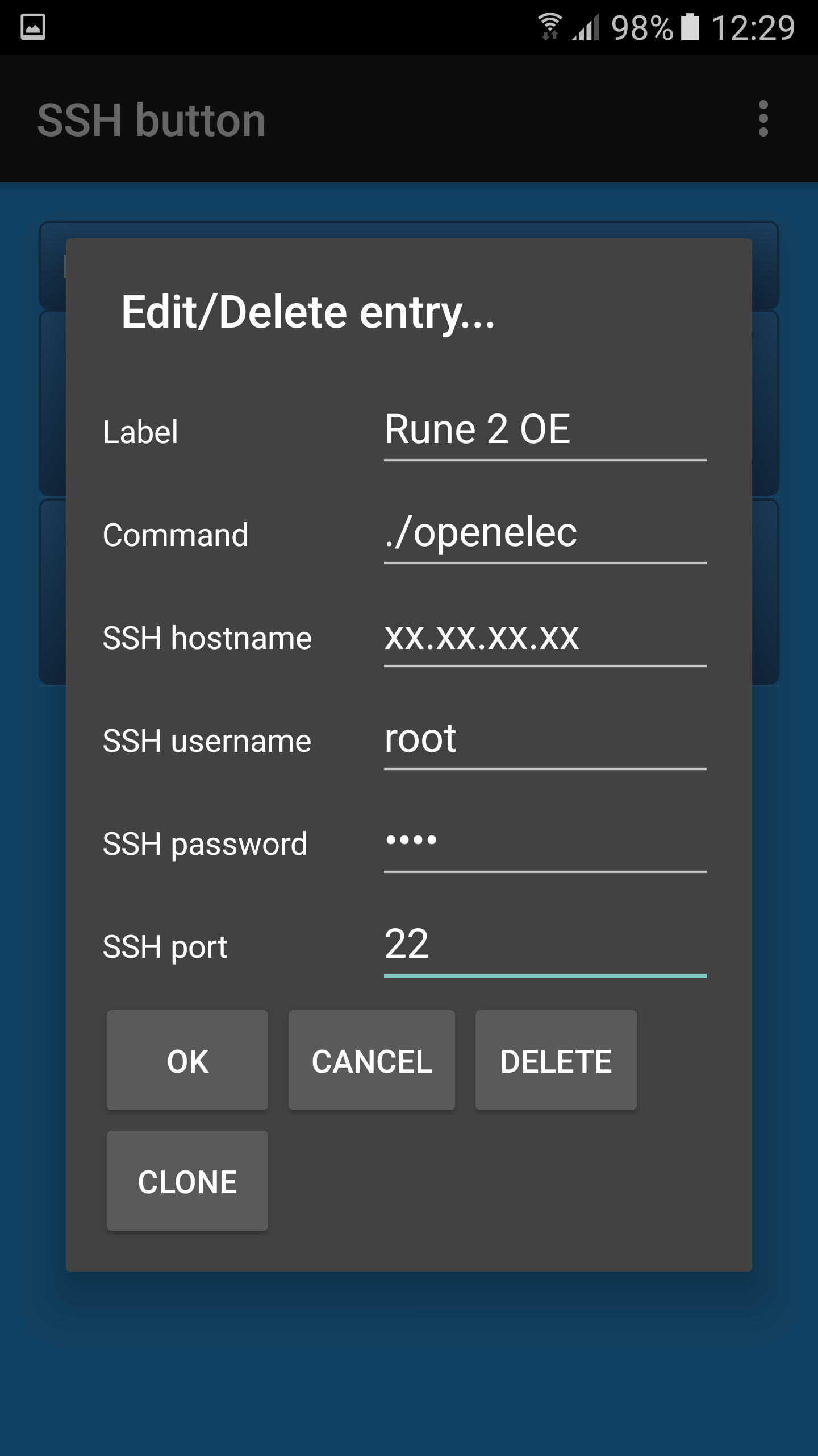

Entry to switch from RuneAudio to OpenElec where xx.xx.xx.xx is the IP address of your RuneAudio setup and password is "rune" (without the quotes)
2016-04-01 10.29.27.png (133.64 KiB) Viewed 4692 times

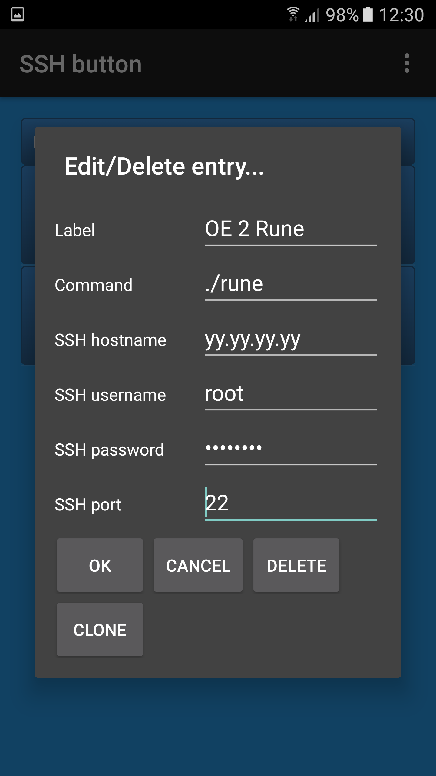

Entry to switch from OpenElec to RuneAudio where yy.yy.yy.yy is the IP address of your OpenElec setup and password is "openelec" (without the quotes)
2016-04-01 10.30.13.png (133.45 KiB) Viewed 4692 times

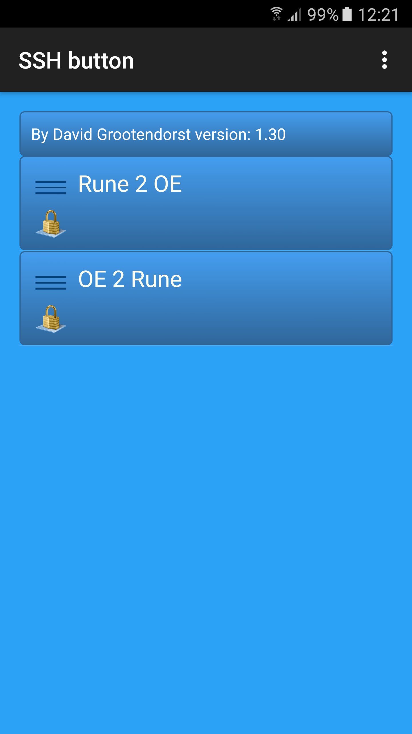

Now you have two buttons to switch from one setup to the other
2016-04-01 10.21.33.png (124.06 KiB) Viewed 4692 times
