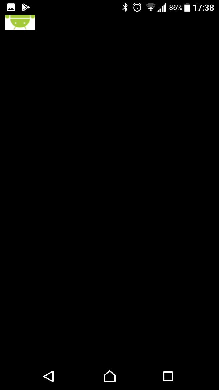

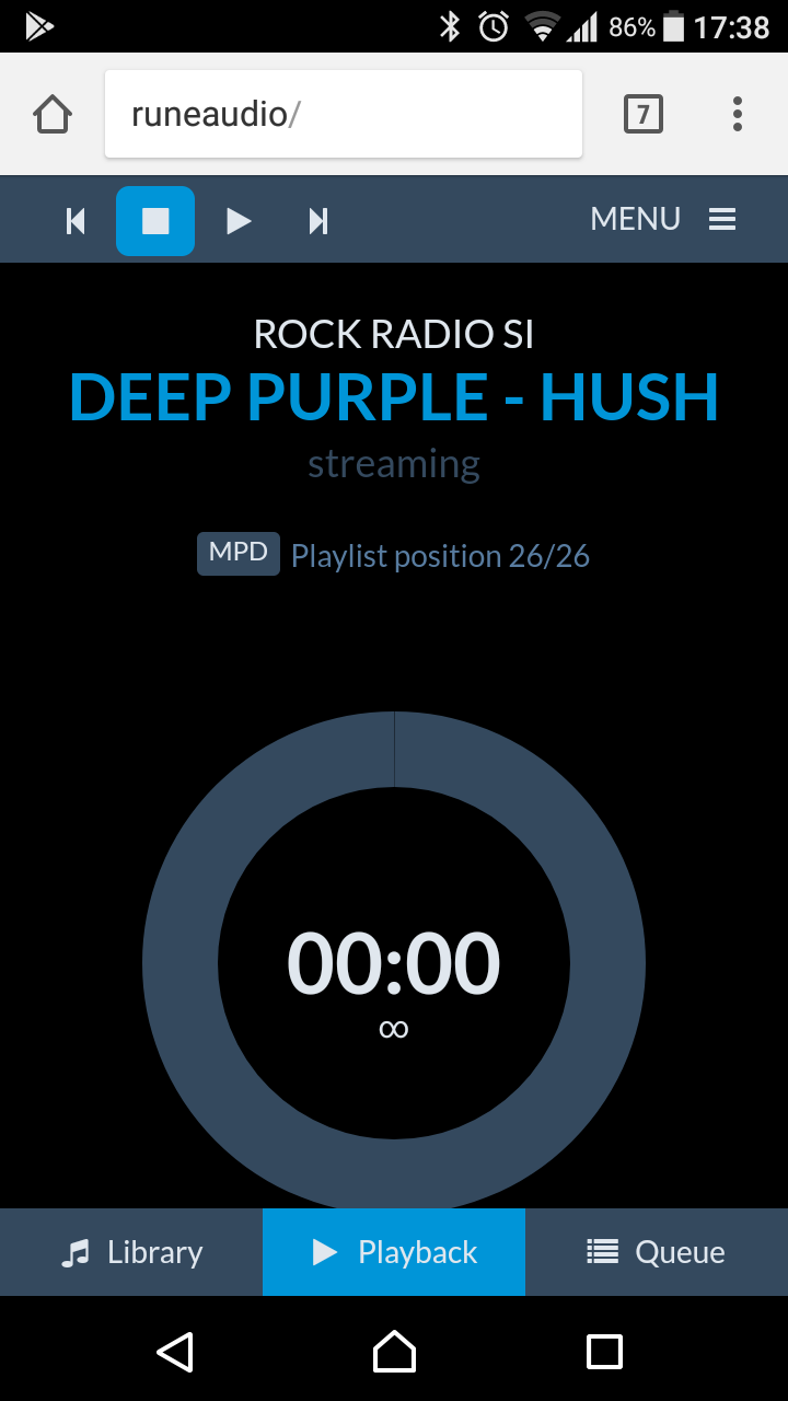

I try to connect to Rpi throw webinterface on phone. Work! App not :cry:
Phone: Sony xperia Z5
runeaudio app
Web interface
