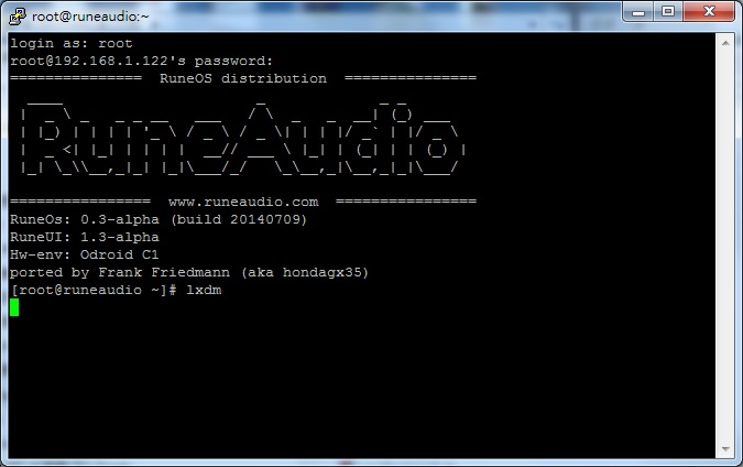

I am going to setup RuneAudio with C1+ and 7" HDMI touch screen.
I follow 2015/11 instruction, when I start lxdm, no response at all.
Please help.
Regards

Postby odroider » 11 Dec 2015, 05:10
You should edit /boot/boot.ini file as described in Page-42 on that Magazine.
Or just use the pre-configured image.
http://dn.odroid.com/S805/RuneAudio_7inch_standalone/

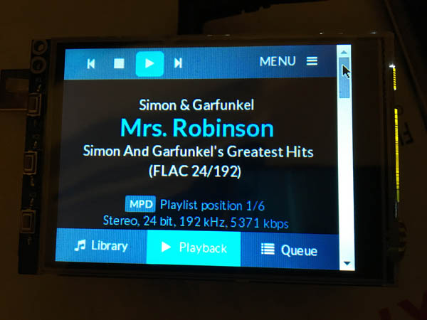

Following guide at few posts.
My 3.2" TFT and C1+ works with RuneAudio.
But How to zoom out to display more information.
Please help
