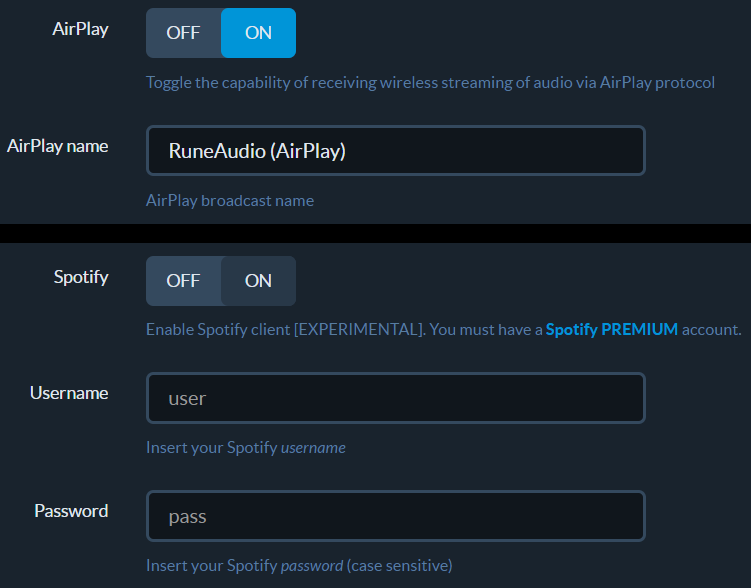

Postby Boilers » 31 Jul 2017, 11:18
Here's what it looks like. All other features seem fine, it's just the spotify button.

Frank,
It turns out I needed to switch my playback source from spotify to MPD. I could then toggle the spotify option and input my login and everything worked fine except for some weird bug where I couldn't adjust the volume. I will note that after spotify was up and running, I went and checked the spotify toggle in settings, and it was once again greyed out. I'm not sure if this is intentional or not, but just a heads up. Thank you for the great support!
