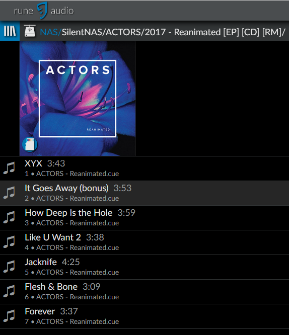

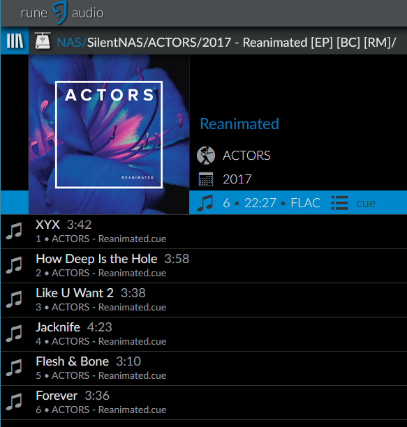

Postby Beelzebassie » 04 May 2020, 11:04
In the library view, the summary on the right side of the album art has disappeared for some files.
Top image is a CD-rip without album art embedded, bottom image is a download that does have the album art embedded.
Thx in advance.
Annotation 2020-05-04 115430.png (181.42 KiB) Viewed 2270 times
Annotation 2020-05-04 115410.png (181.5 KiB) Viewed 2270 times
