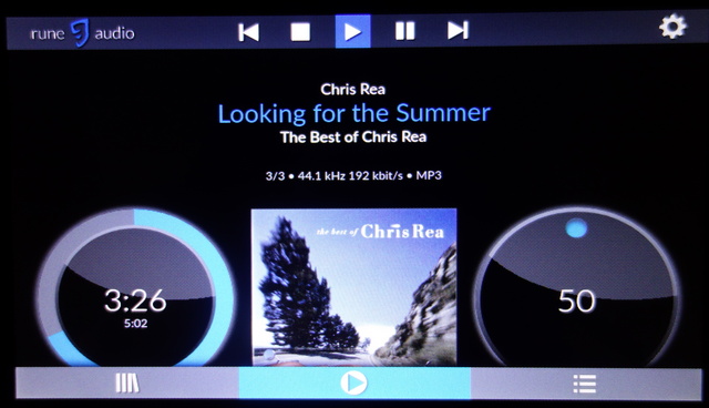

Here is a screenshot of my official 7" raspberry touch display. The resolution is 800 x 480 (not high, but enough for this display that works well). The image can be scrolled up, but in this case, the titles are hidden. No problem with the full screen (without the bars) which is perfectly centered.

On my 7" RPI display, the screen without the bars is not exactly centered as said before. If I tap on repeat or shuffle, it opens "settings". If I scroll up slightly, it's OK.
Another point : I no longer have access to the system on all my devices. Runeaudio reboot and then goes back to playback mode.

Nothing is improved on my 7" display. In the playback screen without the bars, the buttons are now hidden (I have to scroll up). Access to "System" is still impossible, even remotely (reboot for several minutes).
