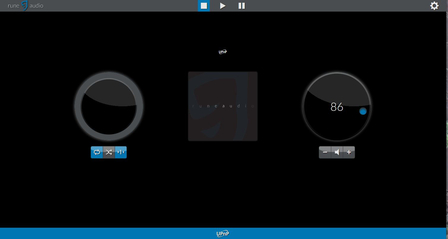

Just applied your latest update (20200401) and my problem got worse. The Library, Playback and Playlist buttons on the bottom of the screen have disappeared and been replaced by a blue UPnP line see attached screenshot. The main screen still shows the UPnP option but in fact the only item in the playlist is a web radio item and I have UPnP turred off as I never use it.

Whoops, spoke too soon. As soon as I added the same web radio again the main screen revwerted back to the UPnP view seen earlier.
Connecting to a non MInimServer provided web radio site such as Eagle Radio at:
http://str1.sad.ukrd.com:80/eagle
seems to work OK. So is RA seeing Minimserver as a UPnP site ? If so it hasn't done this before.
