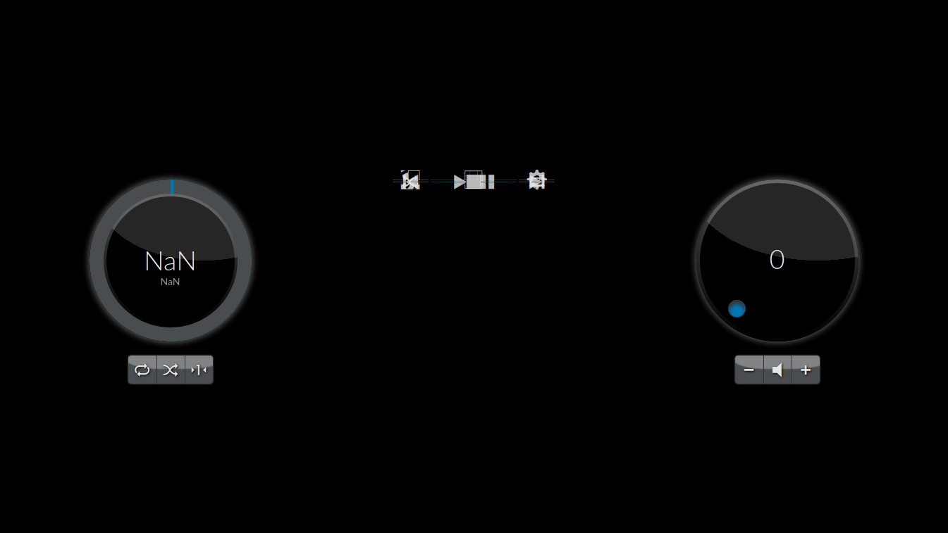

Thanks for the quick reply. I have rebuilt just to make sure not just something gone awry.. still the same with latest update.
I am using a Raspberry Pi 4 Model B Rev 1.2. Output as requested below :
● spotifyd.service - A spotify playing daemon
Loaded: loaded (/etc/systemd/system/spotifyd.service; enabled; vendor preset: disabled)
Active: active (running) since Fri 2020-09-04 22:43:25 BST; 6min ago
Docs: https://github.com/Spotifyd/spotifyd
Process: 436 ExecStartPost=/srv/http/bash/cmd.sh nicespotify (code=exited, status=0/SUCCESS)
Main PID: 435 (spotifyd)
Tasks: 4 (limit: 4915)
CGroup: /system.slice/spotifyd.service
└─435 /usr/bin/spotifyd --no-daemon
Sep 04 22:43:25 runeaudio taskset[435]: No proxy specified
Sep 04 22:43:25 runeaudio taskset[435]: Using software volume controller.
Sep 04 22:43:25 runeaudio systemd[1]: Started A spotify playing daemon.
Sep 04 22:49:16 runeaudio taskset[435]: Connecting to AP "gew1-accesspoint-b-d8j9.ap.spotify.com:443"
Sep 04 22:49:17 runeaudio taskset[435]: Using alsa sink
Sep 04 22:49:17 runeaudio taskset[435]: Loading with Spotify URI
Sep 04 22:49:17 runeaudio taskset[435]: loaded
Sep 04 22:49:17 runeaudio taskset[435]: Running "/srv/http/bash/spotifyd.sh" using "/bin/bash" with environment variables {"PLAYER_EVENT": "stop", "TRACK_ID": "2QNWcYHI1BAhyNylJ4ElTh"}
THen i get flashing rune logo which will stay flashing unil i click it then will take me to this screen which i can press ESC on my laptop to get the menu and then choose reboot to get gui back for mpd/webradio etc. I also note if i lick inside the middle of the left circle it will play the last track.

Postby rern » 06 Sep 2020, 03:58
Hi Roland,
I've just tried a fresh R+R e5, Spotify is running fine.
Try:
1. Reflash the SD card.
2. Don't update, setup or restore anything, just enable Spotify.
3. Connect Spotify from the app on your device.
4. If it's OK, disconnect Spotify and do the update otherwise post the status.
5. Reconnect Spotify.
6. If it's not OK, post the status.
7. Disconnect Spotify and setup audio device, nothing else. Don't restore from backup.
8. Reconnect Spotify.
@yeowds
Setup your HifiBerry Dac+ Pro with System > I2S Module
Re: RuneAudio+R e5
Postby RolandBlaze » 06 Sep 2020, 10:03
@rern,
Thanks yet again for the quick reply. I have done this and believe I have found what breaks Spotifyd for my RPi4. It's caused by disabling on-board audio.. requests a reboot then it breaks the GUI, can be fixed by re-enabling on-board audio and rebooting again. (I use Topping E30 USB DAC so one of the first things I turn off when setting up from scratch).
