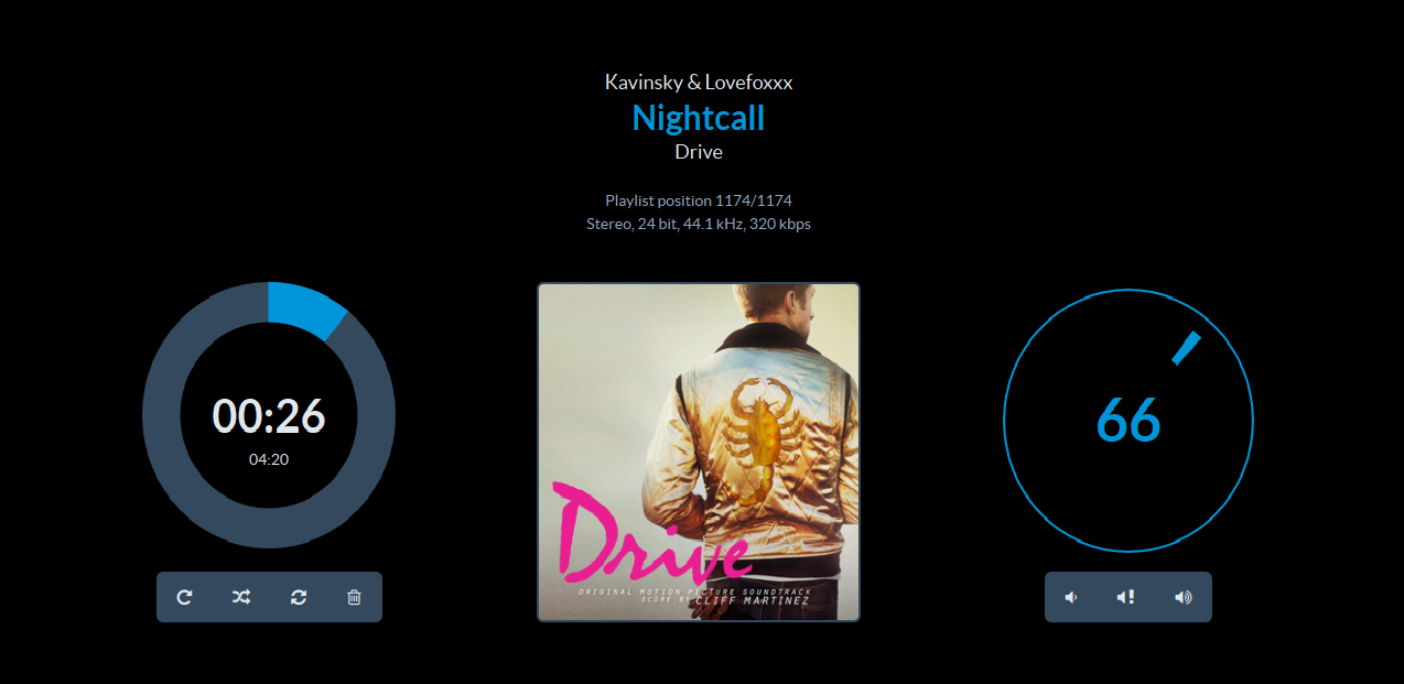

There is a change in the playback view:
On a small screen, i.e. my smartphone in portrait-mode (not landscape), the time "circle" is not presented, even if set in the playback settings. Instead of the time "circle" the time progress bar is presented.
On a first use, I support this change.
