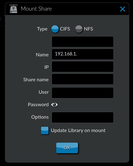

Postby R101 » 22 Nov 2020, 20:11
@rern
In the sources settings, the add share form has the field labels out of line with the fields.
(This is with a new install on a Pi2 using the latest image file.)
