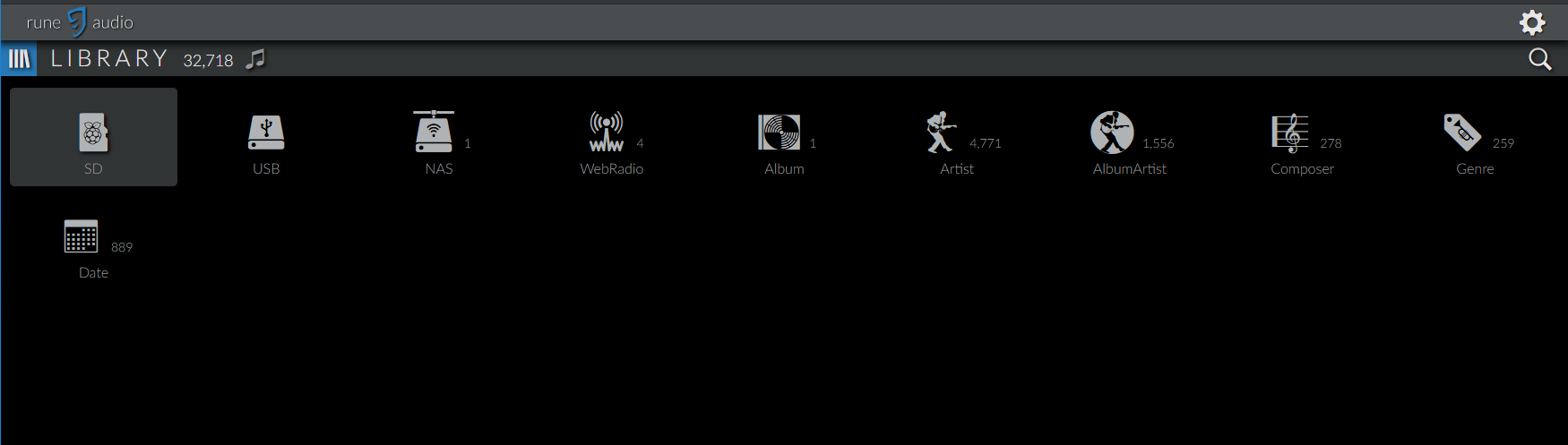

e6 looks pretty nice! Moving from e5 to e6 there seems to be something different in how MPD builds its library. I added MPD logging and ran a rebuild and I don't see any explanation in the log. I only show 1 album from a NAS mounted library that contains quite a few:

The UI doesn't show Songs but the other items show the above number -1 for each but not Album. It shows 1.

I saw some mention of a charset issue. Was there something that changed from e5 to e6 here because it loaded correctly on e5. Is there any way to find an error or indicator for what is causing the Album list to not generate?
Thanks so much
Library Screenshot
Screenshot 2020-12-10 182634.png (51.36 KiB) Viewed 1828 times
