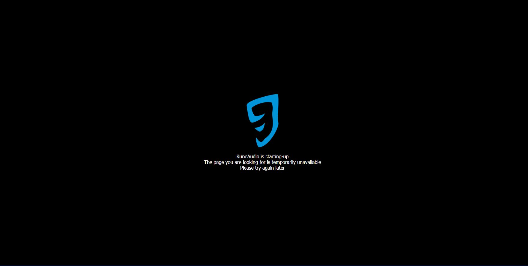

Hi Guys
Still trying to get things working. I have gone back to a different hardware.
But this is happening on all platforms much more regularily - now DAILY?
any suggestions
foxint

Can you confirm if your Rune PI unit is randomly rebooting (software glitch) or physically losing power (power strip, surge protector, bad wall wart)? I confess that I've not established a static IP home network and power outages can cause havoc on my network with DCHP reassigning IPs on reboot.

The fact that foxint is seeing a message generated by the Pi implies that it is connecting to the router OK. It looks as if the UI is not starting for some reason.
foxint,
Have you logged in to the router to make sure connection is not being lost during boot-up?

Same message. I went into the router and the IP address for the Pi was (within minutes) assigned to another device (it was wireless, and the name was “you”)
The Pi has a fixed IP address – I am stumped.
I have now pushed the fresh thing on Chrome, and I got the RuneAudio page and the radio.
Strange, I checked the router, refreshed it again…. still shows that the device is wireless. But it is connected with Cat-6??? In the old days, the Hostname was RaspberryPi…. but not now

It sounds like it could be as simple as another device is being assigned your Rune PI's static IP while it is powered off by the network? Maybe bump your PI's static to up by a 50 or 100 increment, IE old static IP of 192.168.0.10 becomes 192.168.0.110.

I suggest you disable the wifi and bluetooth on the Pi, (used to be in the file "/etc/modprobe.d/disable_rpi3_wifi_bt.conf" but might have changed) and delete the wireless settings. Either that or unplug the ethernet cable and use the wireless connection.
It might also be worth checking that you do not have two devices asking for the same fixed IP, and that the fixed IP you chose is not in the router's DHCP range.

If I understand the postings so far, the fundamental issue seems to be that the Pi doesn't stay on the correct IP address. If so, it would be good to know exactly how you've assigned a fixed IP address to the PI. Are you trying to do this only on the Pi (Menu > Network > IP assignment > Static > your preferred IP address numbers), or have you configured a list of static IPs on your router? Given that something else seems to be stealing the IP address you want to use for the Pi, I wonder if your network setup is inadvertently allowing different devices to compete for the same IP addresses.
IMHO the only safe and reliable way to use fixed IP addresses is to configure a list of them on the router, and nowhere else - normally the router would be set up as your network's DHCP server anyway, so it's already responsible for allocating IP addresses (fixed or not) to all your client devices. Once you've set up a list of fixed IPs (including the one for your Pi) on your router you should configure all your network client devices (including the Pi) to use DHCP instead of Static IP - the router's then in complete control of the numbers throughout the network, and the Pi just uses the number that the router's assigned to it.
While you're in the router's static IP config section it wouldn't do any harm to assign separate static IPs for each of the PI's wired and wireless network interfaces.
