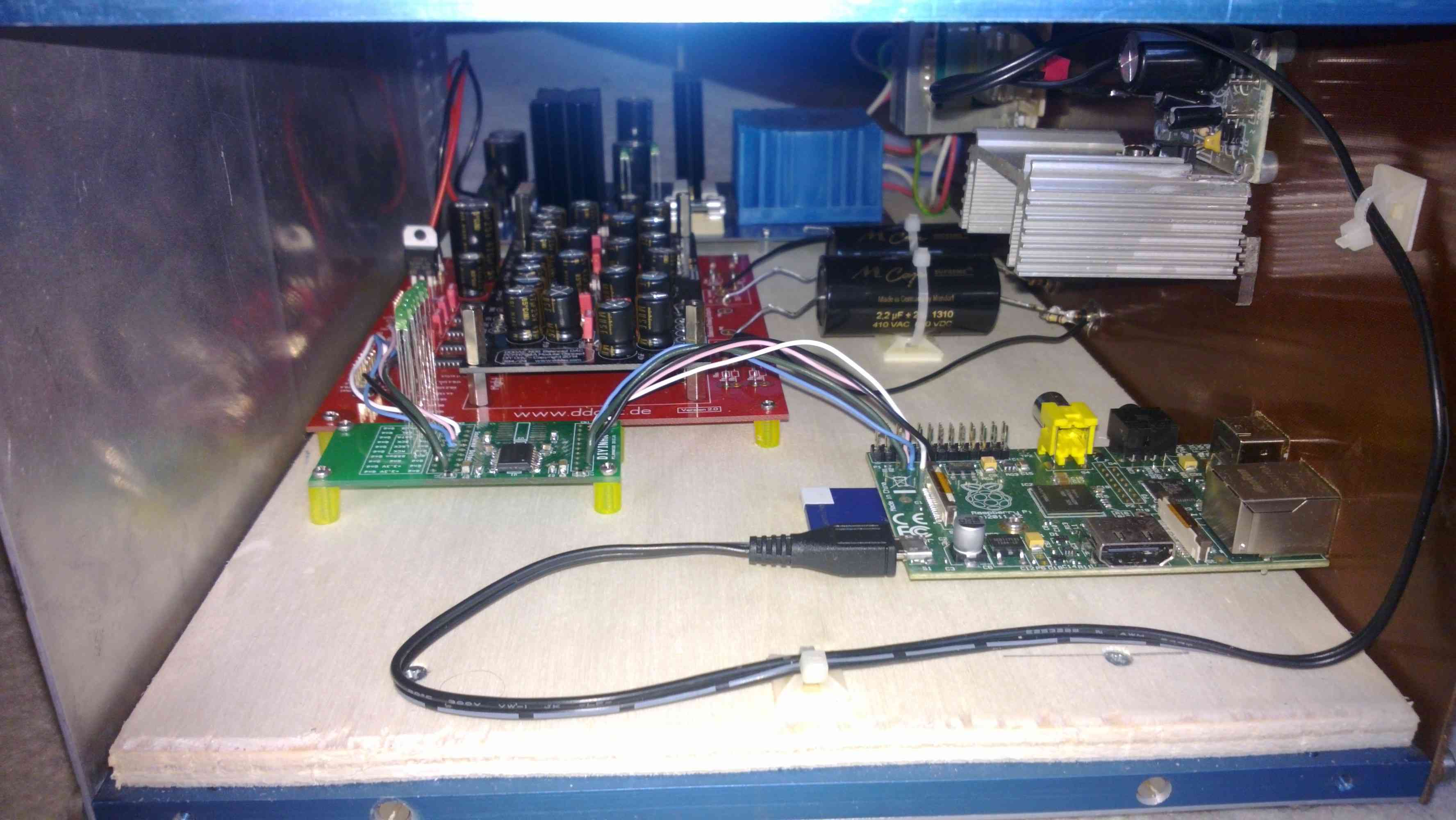

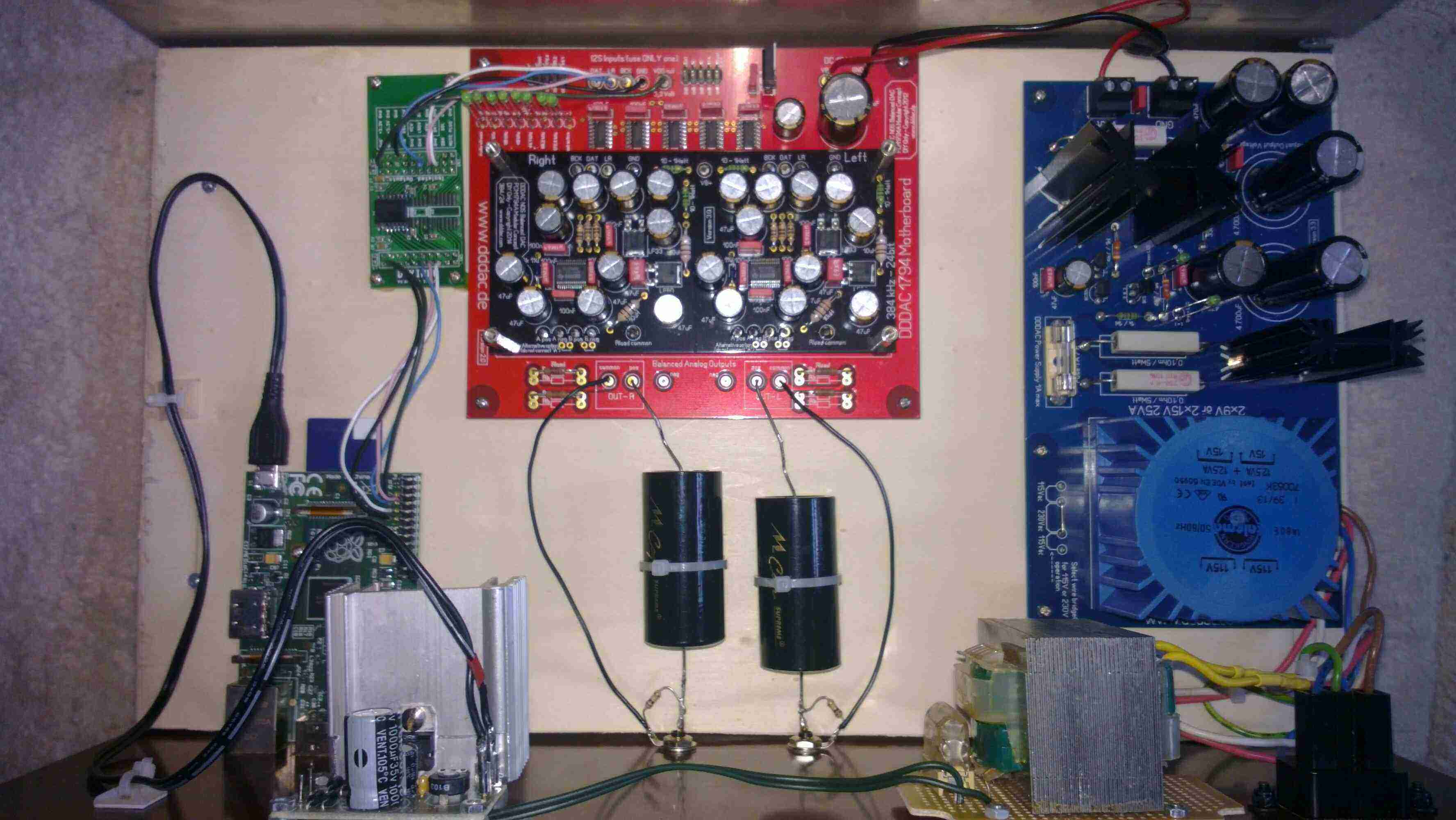

Hello everyone,
we (some friends from and near Wien, Österreich) have our little project up and running, and finally everything is like it should be, thanks to RuneAudio 0.3 alpha. :-)

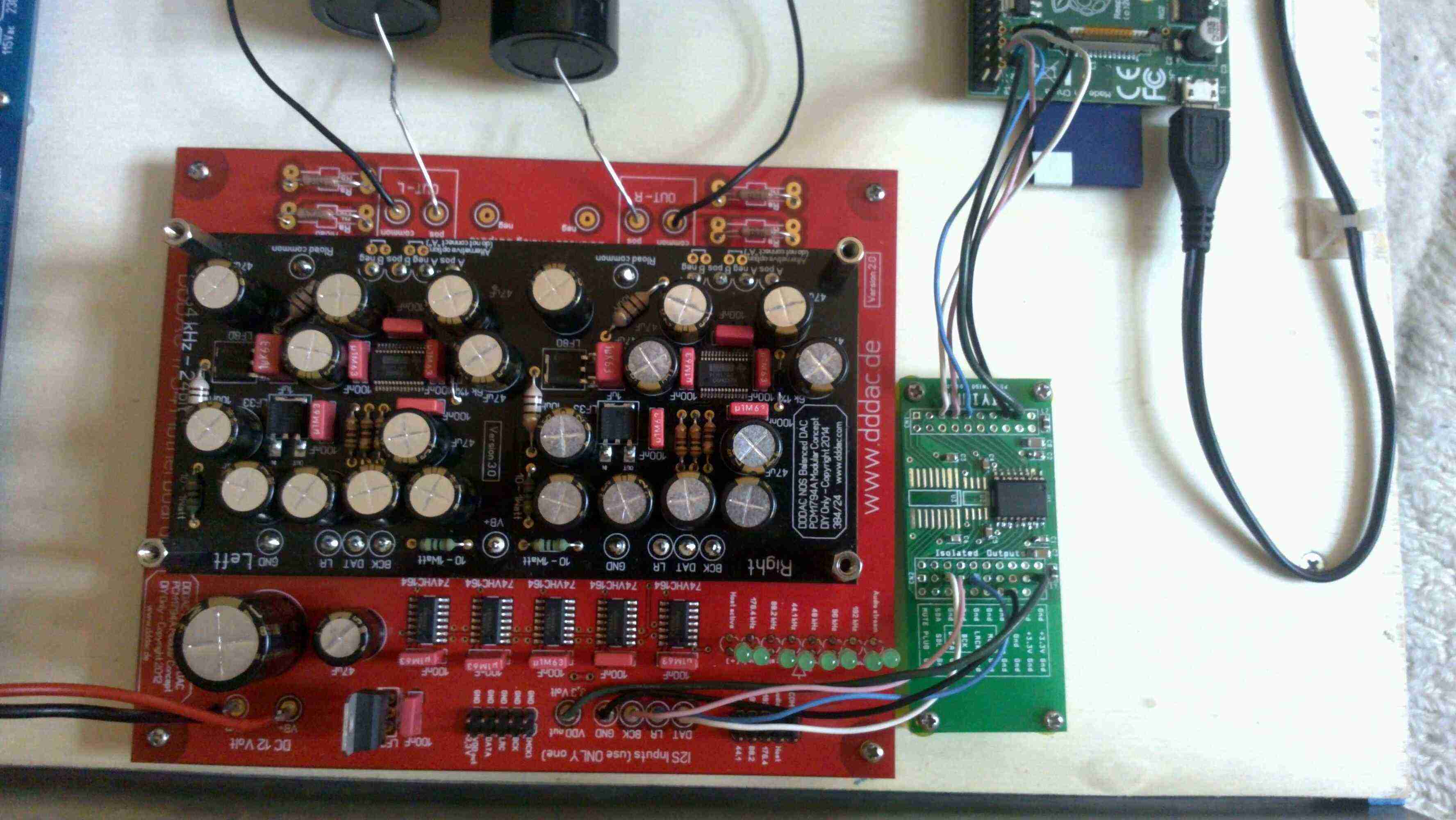

There was only one problem with playing Flac-files, instead of using the Hifiberry-I2S-module we had to use the module snd-soc-pcm1794a, as with the DDDAC1794-NOS the output is mono when playing FLAC-audio-files with our special setup.

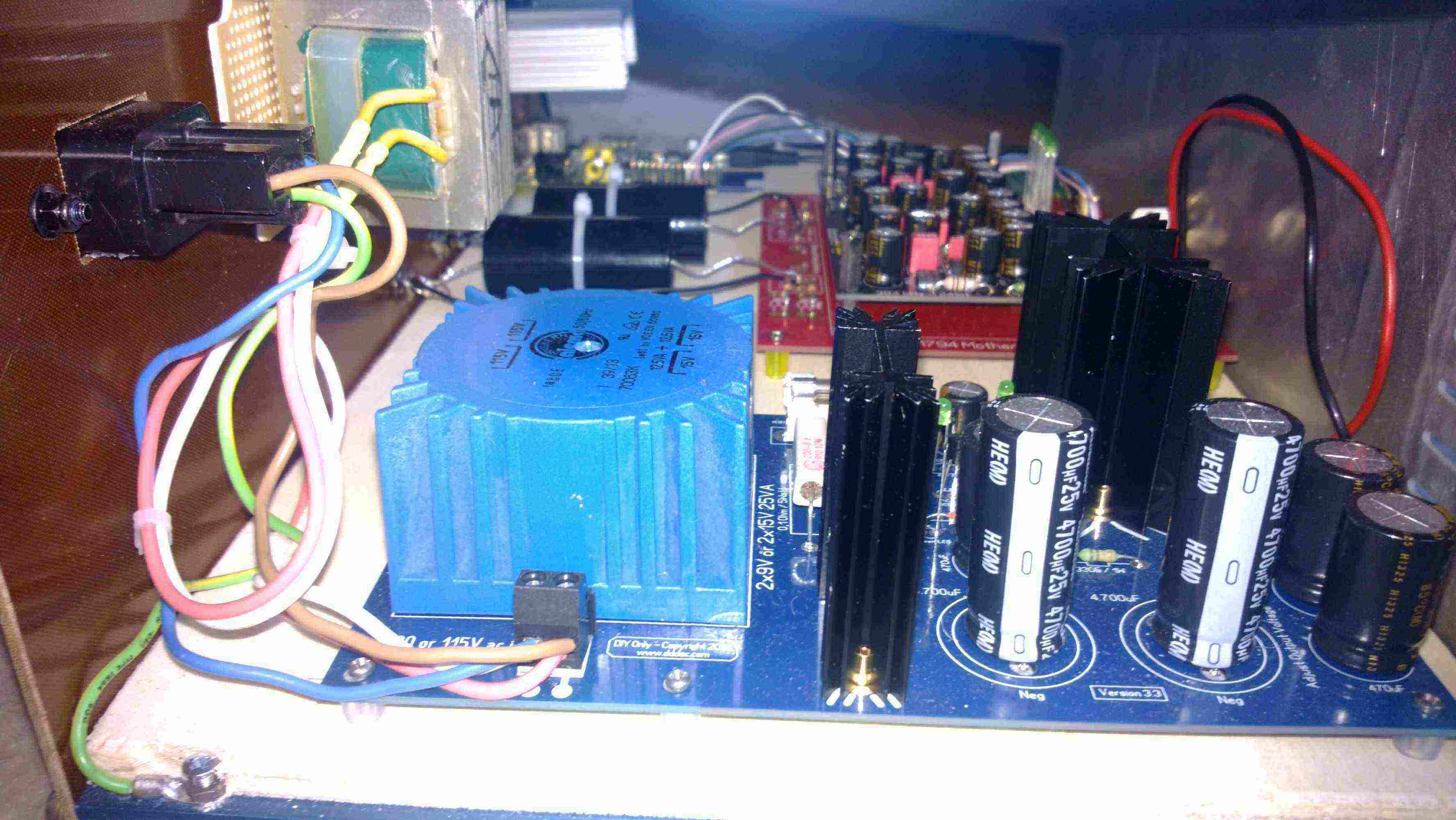

It consists of a RaspberryPi-Model-B connected through I²S with a DIYINHK-isolator (for isolation of the I²S-signal between Raspberry and DAC) , which is wired to the DDDAC1794-NOS, designed by Doede Douma (http://www.dddac.com/dddac1794.html), using RuneAudio to play our files (Flacs up to 24bit/192kHZ, Mp3s...).
Here are som pics, for wireless-control there is an Edimax-EW-7811Un-wireless-adapter in one USB-port, the other is used for the external-hdd containing the music-files.

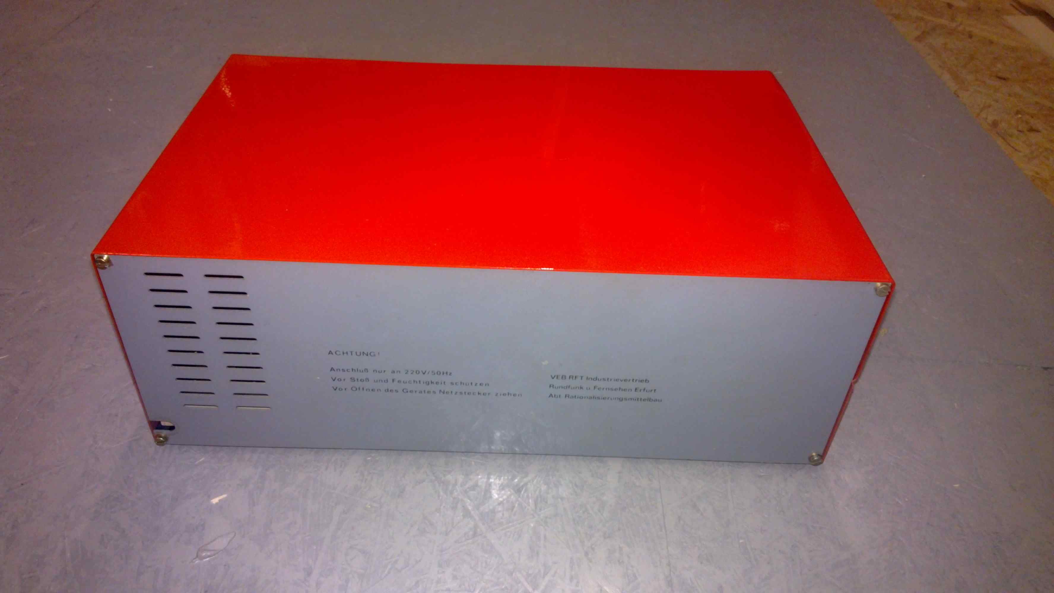

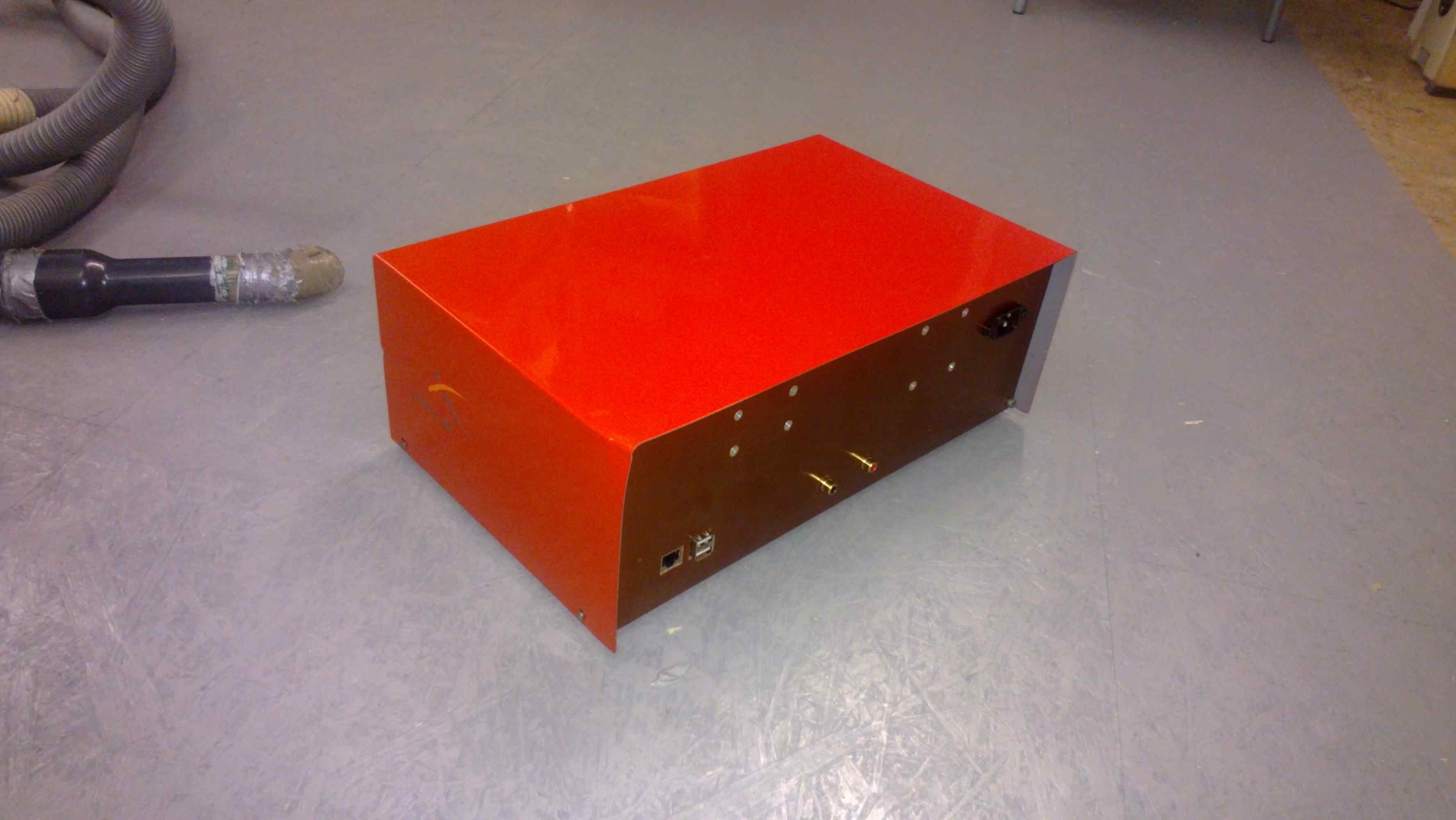

The aluminium-case is from ebay, it was used in East Germany in the 'Abteilung für Rationalisierungsmittelbau' long time ago, but perfect for our needs. :-)
