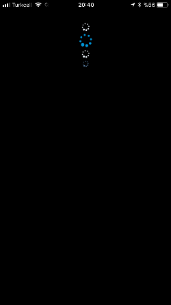

- While using airplay iphone screen shows just spinning dots

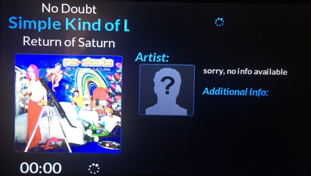

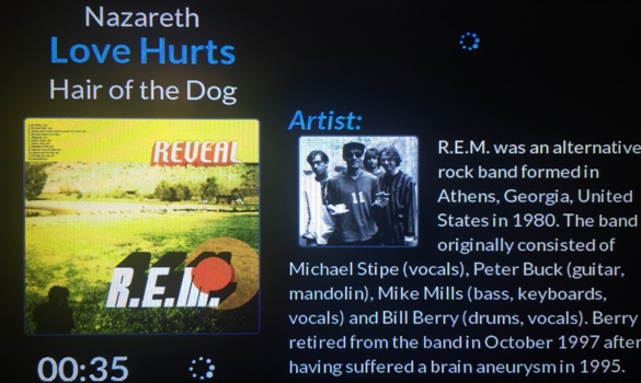

- On local browser detailed information screen shows either no information and spinning dots
or you see information about another artist and spinning dots again. Is there any way to completely disable this layer, as it slows down runeaudio and causes lags in music.

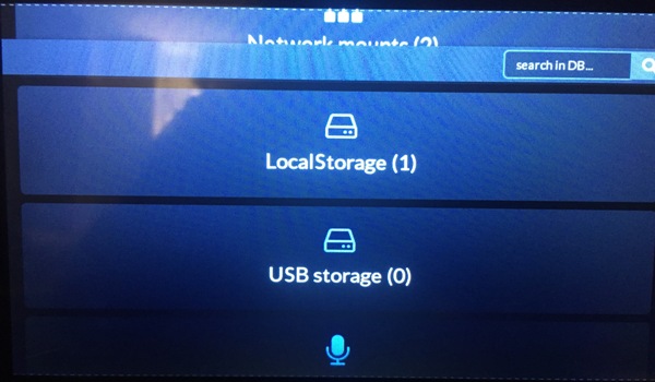

- On local browser menubar in sources and playlist screens is actually not on top of screen, there are some empty pixels above menubar.

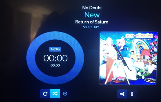

- On local brower while playing via airplay, now playing screen shows some other content (actually last song from mpd mode)
