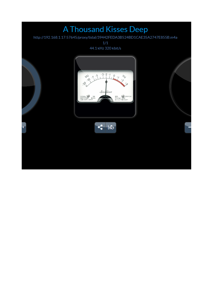

Postby Ripa » 14 Sep 2018, 11:10
Hi Rern,
FIY
When i play with bubble upnp i see on the screen below the track
the address instead of the artist name.
you see now an VU meter not the picture off the album can you make this optional?
spotify is correct
tital
thanks
Ripa
