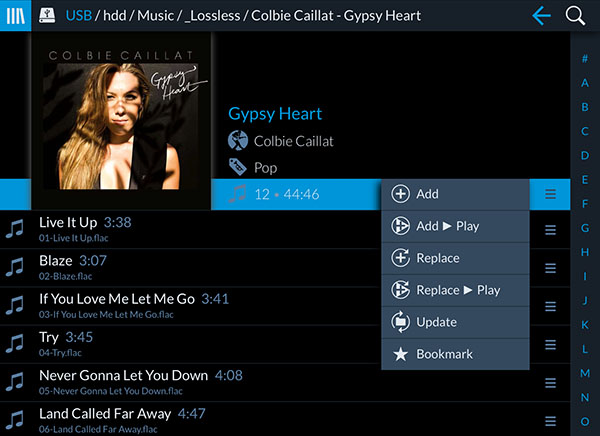

Improve *.cue Files Browsing
- Directories contain *.cue will directly show song list like normal directories with separated files.
- *.cue can be single or multiple files.
- Any song in the list can be added to Playlist as a single song.
Cover Arts In Library
- (This is not yet browsing by cover arts)
- Show cover art with info in destination of each mode.
- Bio on click artist name like Playback page
- Context menus are available directly in cover art.
- Disable Library cover art in Library items menu.
