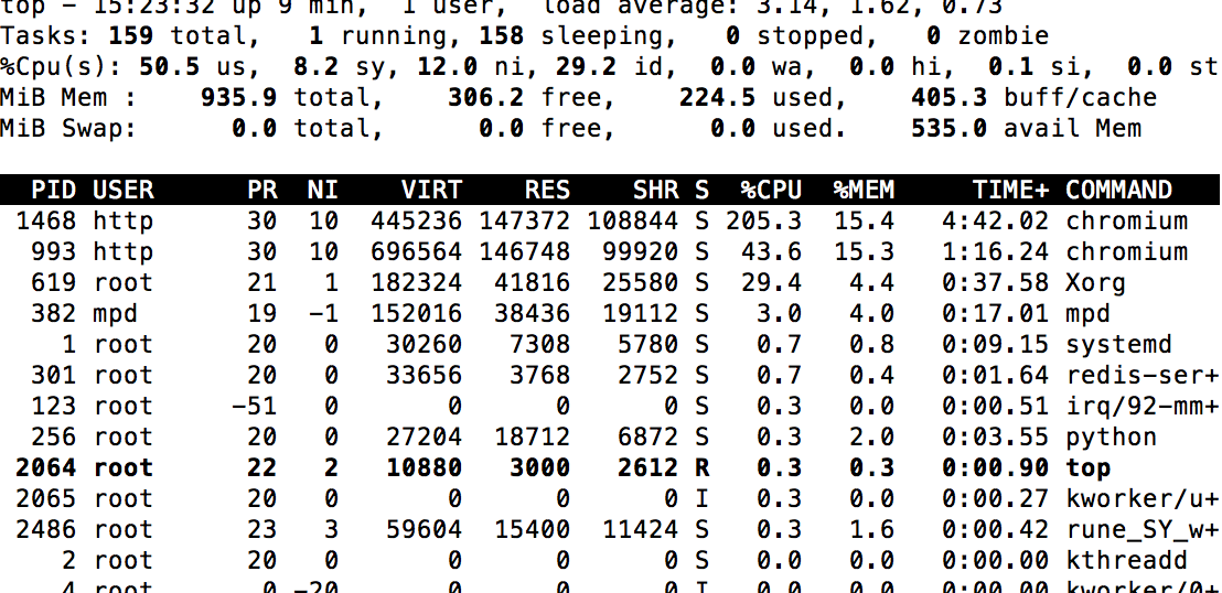

Postby vennesch » 01 Mar 2019, 14:30
Hi there,
I love the enhanced UI. But the problem is, when I use my local browser (which I prefer) and when I play webradio, my RPI 3B is directly throttling. This is only the case when I am in the playback screen. I find it kinda strange because it is not the most difficult task to perform for this CPU I guess.
Already tried to set turboboost to 0 and to put GPU-mem at 32/64/128/512 but that did not resulted in a solution.
Can you recommend any settings in my config?
And if not, is it possible to have the option to turn off the animated VU meter? (would be a pitty, but then at least I could enjoy the rest of the eye candy)...
My configuration:
RPI 3B, Hifiberry Dac Plus, fast 32GB card, hooked up to receiver and tv, bluetooth disabled, webradio via WiFi
RuneAudio. 0.5B build 10 (tried 7 and 9 with same results)
Any suggestions?
thanks in advance
Simon

Postby vennesch » 01 Mar 2019, 15:26
Schermafbeelding 2019-03-01 om 15.23.26.png (129.41 KiB) Viewed 2084 times

@rern looking at my screenshot, can you point down where the unusual CPU-load comes from? I googled the PSID but can't find anything.
Thanks in advance
