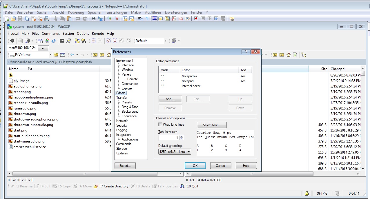

Hi rpt007,
i can not help with your problem but have a tip for you.
Use and on your host PC to edit files.
If you are on a MAC you can use instead.
Do not use built-in windows editors, because they may break file encodings and line endings.

@hondagx35:
Frank, I used WinSCP which comes with a line counter. Is there an easy way to use Notepad++ as I have no experience with using NP++ as SSH tool (I found it a bit confusing where to tell it to set up a ssh session (I am pretty new to all this here, so be easy with my :-) )

Postby hondagx35 » 03 Feb 2017, 18:07
Re: RuneUI Enhancement
Postby rpt007 » 03 Feb 2017, 20:36
Frank,
thank you. That is the way I was looking for. I know that np++ is an editor but I didn't know how I vould use it within a ssh session. Now my life will be easier.
