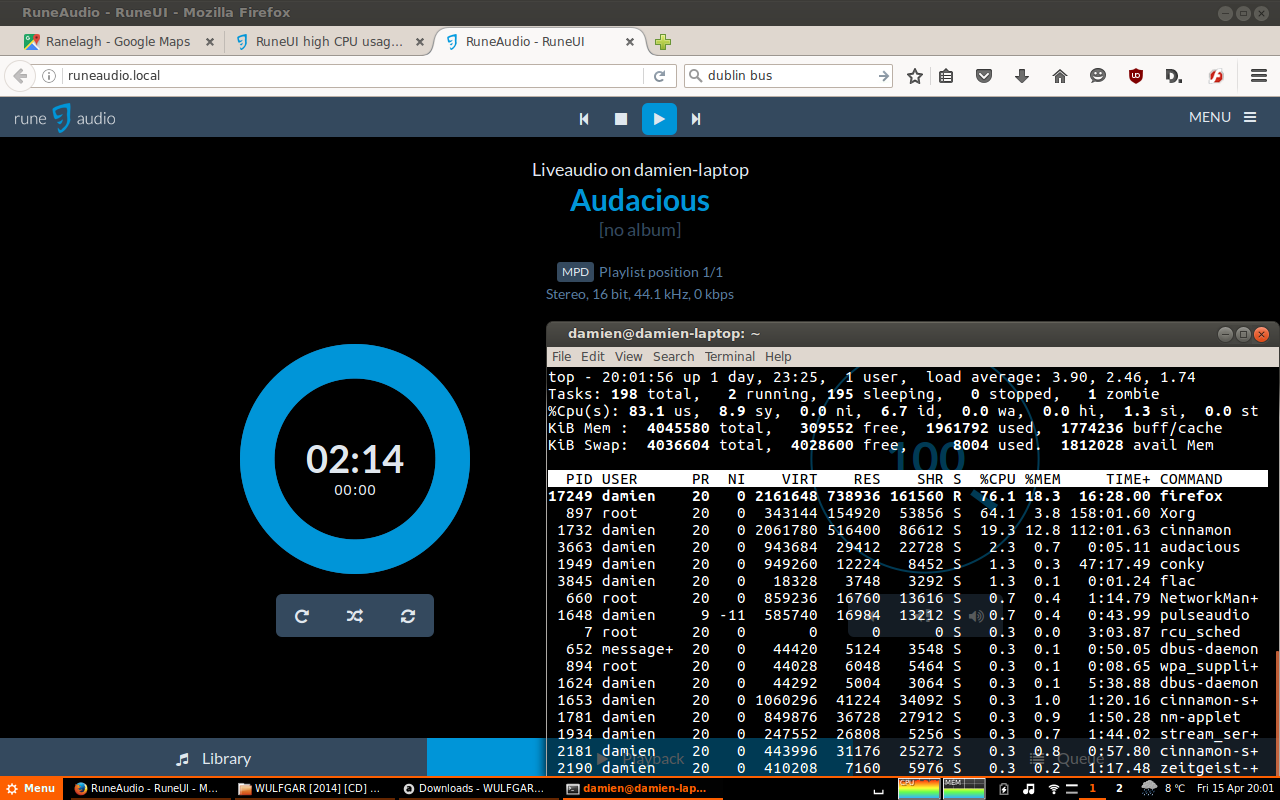

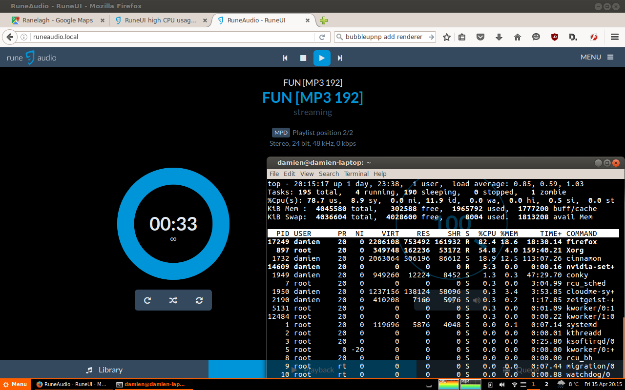

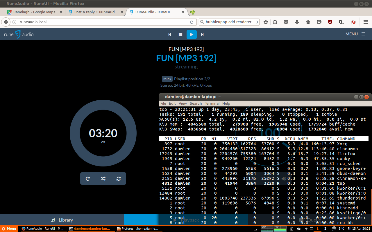

Postby The Setlaz » 15 Apr 2016, 20:41
It should just happen. I attached 3 other screenshots streaming from my Laptop through DLNA and playing Webradio.
The 3rd one is the same Webradio but the circle drawing didn't start (bug?) and when it doesn't start there is no CPU load.
Is the circle being drawn in your test?
Webradio and no blue circle
Webradio
From Laptop to RuneAudio

Postby ACX » 15 Apr 2016, 23:51
Ok, I managed to reproduce it, and the problem is indeed in the knob animation. The CPU load jumps up only when the knob is animated, which doesn't happen always. I'll dig into it.

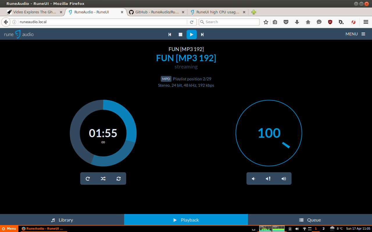

Postby The Setlaz » 17 Apr 2016, 11:10
Seems to be fixed on my end too! Thanks a lot for that!
Added a screenshot for the blue knob color Pete was talking about. (need to click & drag to draw the circle)
Regarding the scrolling I do have CPU load as well when scrolling but I get it on any website so it seems more of a browser thing rather than a RuneAudio problem.
