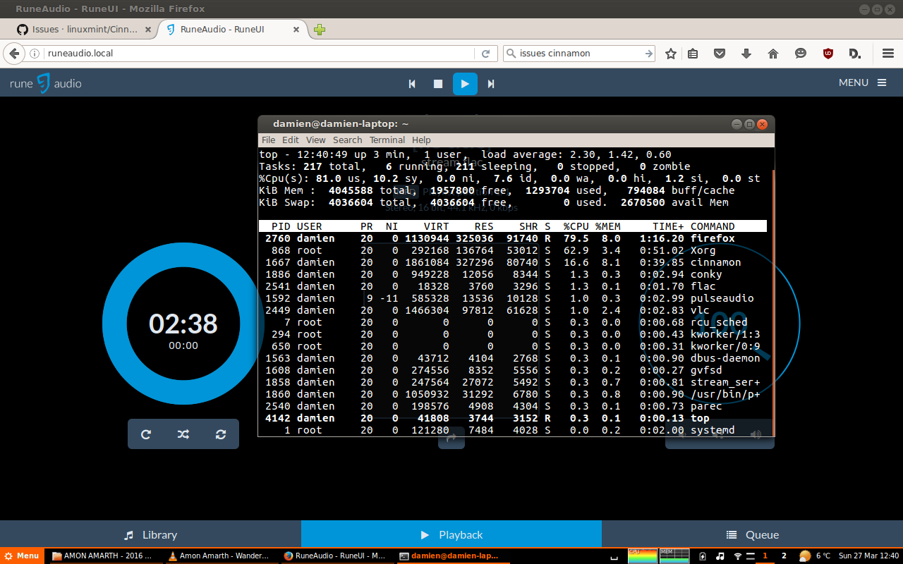

I noticed my laptop CPU usage goes to 80% usage when browsing on RuneUI interface when streaming audio through DLNA. Resources are taken by Browser and Xorg.
As soon as I switch tab or set pause the music from RuneUI, CPU usage goes back to normal (10%).
This only happens from streaming through DLNA / listening to Web radio, but not when playing music from RuneAudio Library.
I wonder if this has something to do with the time counter / circle drawing?
Or is it just my too old CPU? :oops:

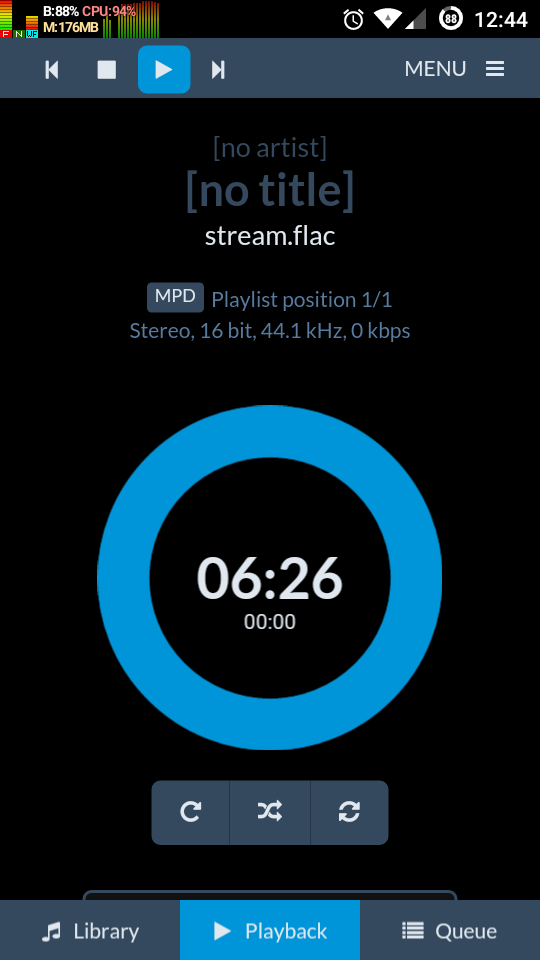

EDIT: this also happens on my Android phone on with the RuneAudio app
RuneAudio on Raspberry Pi 2 with latest RuneAudio (git pulled)
OS: Ubuntu 16.04
Browser: Firefox / Chromium
CPU: Intel Core2Duo T7100 (don't laugh, it's still working fine :mrgreen: )
Phone: HTC One S (MSM8960)
Phone CPU usage
Laptop CPU usage

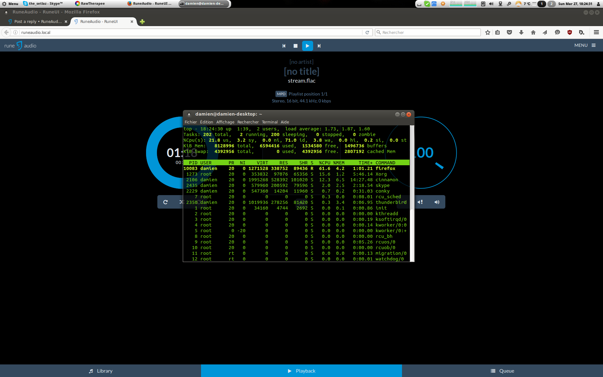

Now that you mention it, I went on RuneUI from my desktop (Ubuntu 14.04 + Firefox) that has a Core i5 3570K, top reports 60% CPU usage :o (System-monitor shows the 4 CPUs averaging around 25% each instead of 5%)
That would definitely be a battery killer on mobile devices too.

I just flashed the new image, unfortunately I'm still seeing the problem. :oops:
Webradio shows time as infinity but DLNA stream shows 00:00.
In both cases, I have high CPU usage. It also seems that CPU usage is higher once the time-circle is fully drawn (blue)
I also tried on Windows 7 + Firefox on my desktop and I also see "above than normal" CPU usage (but not as bad as on Ubuntu).
Thanks for helping on this!

What is this "stream.flac" file you have shown in the picture?
