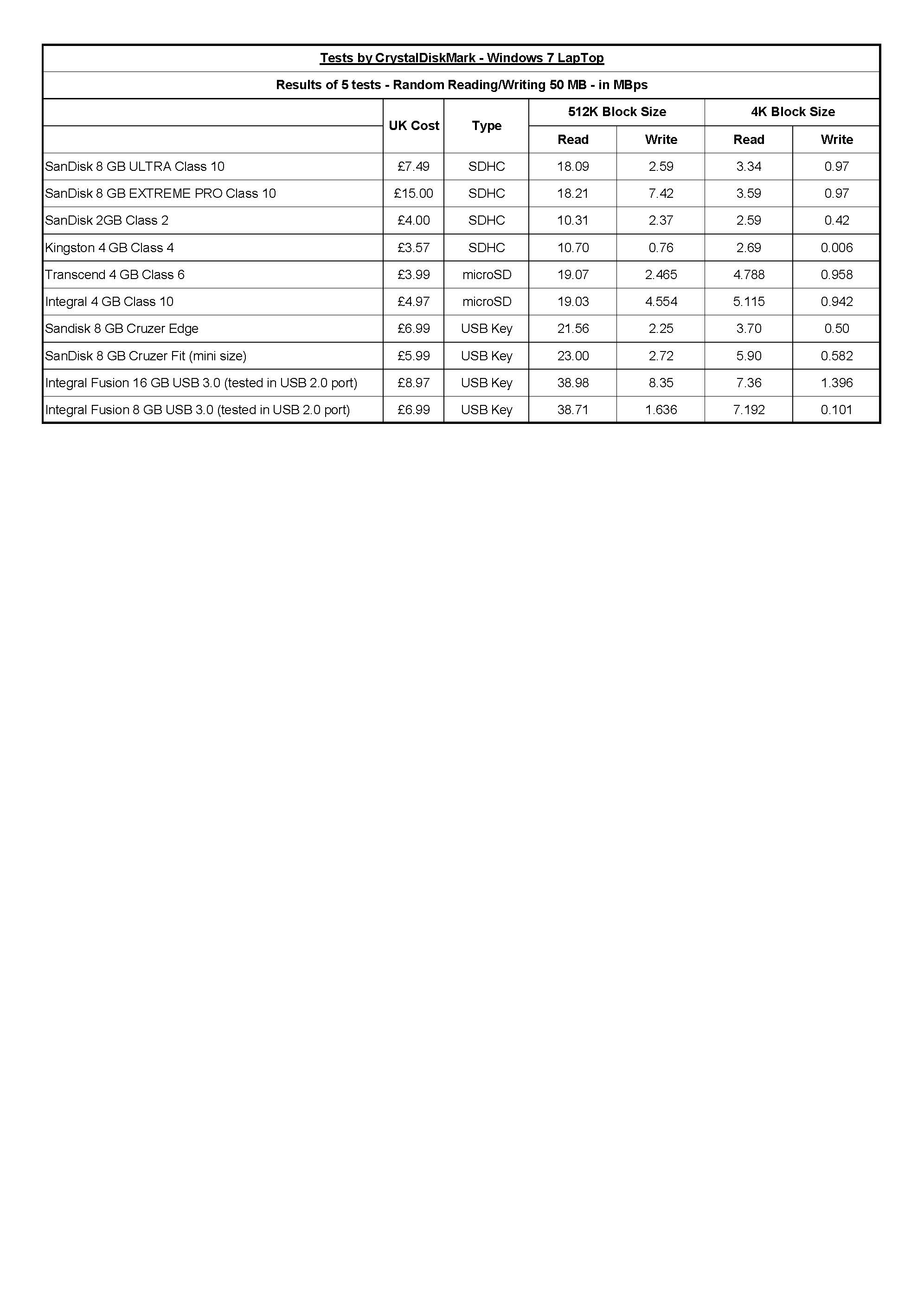

I’ve been interested in SD card & USB stick performance for several RPi projects and have tested a few. My results are in the attachment. The absolute values will not apply to RPi but the relative values may well apply. (UK cost is what I paid during the past 12/18 months and costs are coming down)
They have convinced me to put the second OS partition on a USB 3.0 stick and just boot from the SD card. And there are lots of people suggesting this on the Raspberry forums – not just for speed but to avoid card corruption, wear, etc. There are other postings on this forum too.
I picked up on the @Fishstix suggestion to run Debug with the thought of using the time taken as a benchmark. I tried it (Rpi B+ with iqAUDIO DAC+ running updated 0.3 alpha on an Integral Fusion 8GB USB 3.0 stick) – did it 4 times – 11.737, 3.887, 3.753 & 3.885 secs. I assume the first run involved a one-time set up?
So no evident benefit of using a USB 3.0 stick. But had a eureka moment and over-clocked my RPI B+ to TURBO mode via config.txt. Doing Debug 4 times gave 6.928, 2.359, 2.347 & 2.352 secs!
And the UI was much nippier – and on the basis of no evidence whatsoever, I imagined that things were ‘going better under the hood’ in general :)

That's some sweet info! Thanks for putting it together. I would not have expected a USB drive on a 2.0 port to run faster than a fast SD card; the manufacturer's specs usually read lower. Proof is in the pudding, though.
Reading more on the Pi forums, I am hearing that Class 10 SD cards are geared for generally higher sequential, single large file read/write rates. (e.g. 1080p recording.) Throw a few small files at them, and they struggle; they are not built for multitasking work, so maybe not the best medium for an OS to begin with. It makes me want to pick up a solid USB flash drive and see how it plays, even with the limited 2.0 ports. But then again, RuneAudio is, from what I understand, a pretty lean system anyways. Maybe it's multitasking needs don't much cramp an SD card's style? Either way, this new Class 10 makes a noticable difference; it's fast enough I can't count on my fingers anymore... ;)
