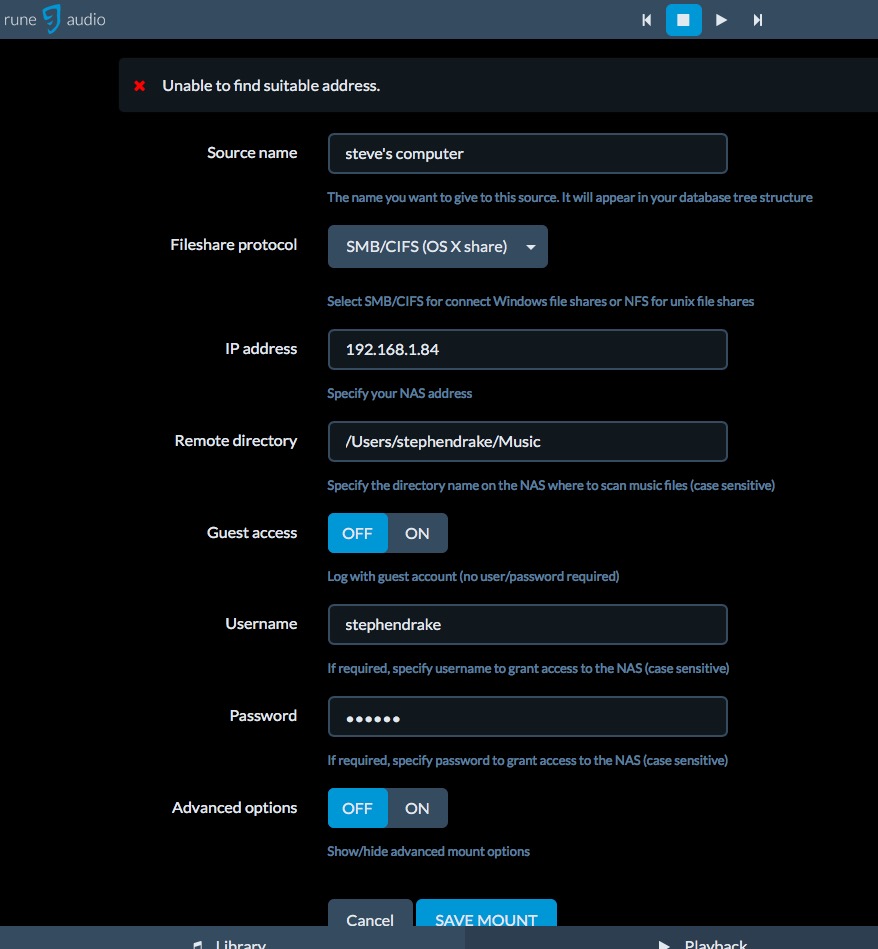

My idea is that I should be able to connect to this same computer via the NAS Mounts section, so I've set it up as best I know how, but keep getting the error "Unable to find suitable address".
I've attached a screen shot of my settings - any obvious errors?

Try losing the leading "/" of the remote address.

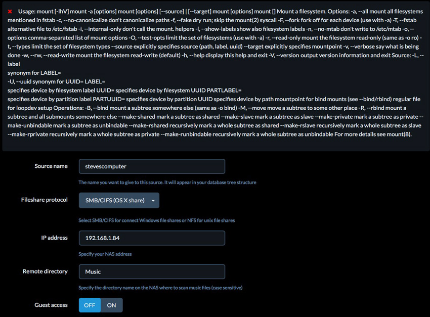

Postby hondagx35 » 18 Mar 2017, 17:24
Hi sduck,
try:
"Music" as Remote directory.

Postby hondagx35 » 18 Mar 2017, 18:23
Hi sduck,
the message displayed means that you have a syntax error in your mount command.
Does your password include special characters or white spaces?
If so please try to use a password without these characters.
