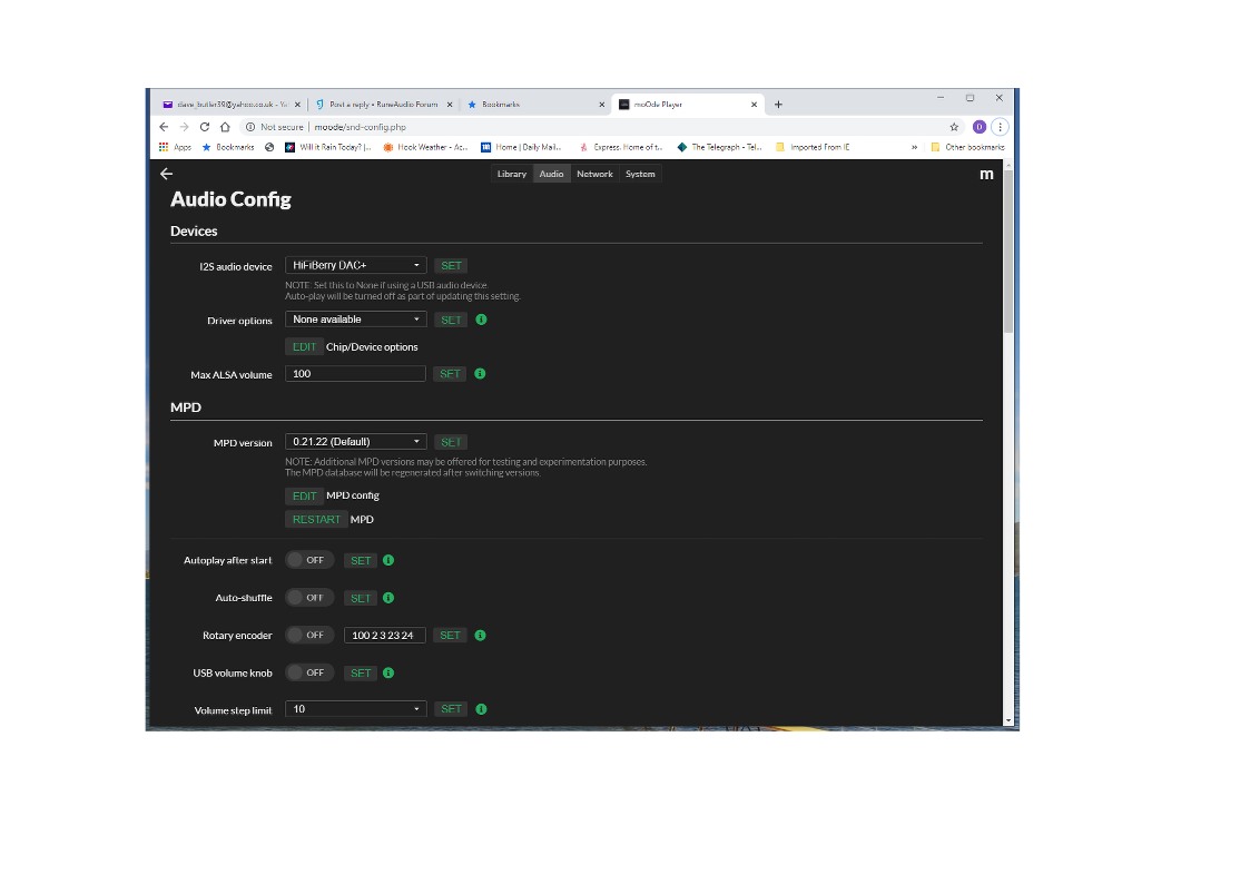

As for the competition, MoOde, for example, permits adjustment of the Alsa Mixer within its configuration pages (headlessly, via browser - see attachment) Rune, to its discredit, needs command line changes The earlier Rune installation image required config.txt changes to accomodate the various I2S HAT's. MoOde lets you select your DAC or whatever from a drop down list. It seems like Rune is not being updated as it should be to be taken seriously and usable by people who can do some basic stuff like flashing SD cards and configuring the system, accessing NAS drives etc (or not accessing them in several alternatives - Max2Play apparently wanted me to change the entire file structure of my Synology NAS).
Easy Alsa Mixer set up in RoOne
