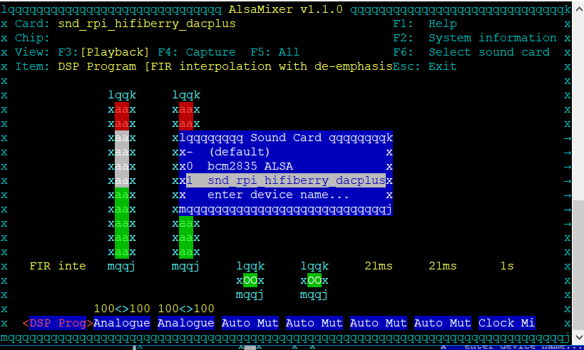

OK I am using an analogue DAC hifiberry with two rca jacks for left right. I tried setting the device to 1 and the mixer to analogue but it wont go. If I use device 0 and mixer PCM it starts. Not sure what I need to do to get it to use the DAC in analogue working

RuneAudio --playback_device 'sysdefault:CARD=IQaudIODAC' --mixer_device_index 1 --mixer Analogue
Thanks, That last bit helped, took me a while to figure that my DAC was device 1 and the sysdefault parameter was absolutely necessary.

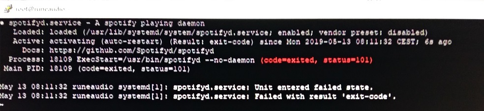

I'm new to RuneAudio and in the last few days I'm unsuccessfully trying to install spotifyd.
I have a Raspberry Pi 3 Model B with a Kuman SC07C Raspberry Pi HIFI DiGi+ Digital Sound Card (that I know it's more ore less equivalent to Hi-Fi Berry Digi+ and it uses the same driver). RuneAudio version is RuneAudio_rpi2_rp3_0.4-beta_
I followed all the instructions on https://github.com/Spotifyd/spotifyd/wi ... spberry-Pi and I uncommented the line dtoverlay=hifiberry-digi on config.txt.
But when I start spotifyd.service and check its status, I get what you read in the picture.
Can someone help me to understand what the problem is?
Thank you

Hello janui, thanks for the answer.
I get the spotifyd command list correctly. No error.
