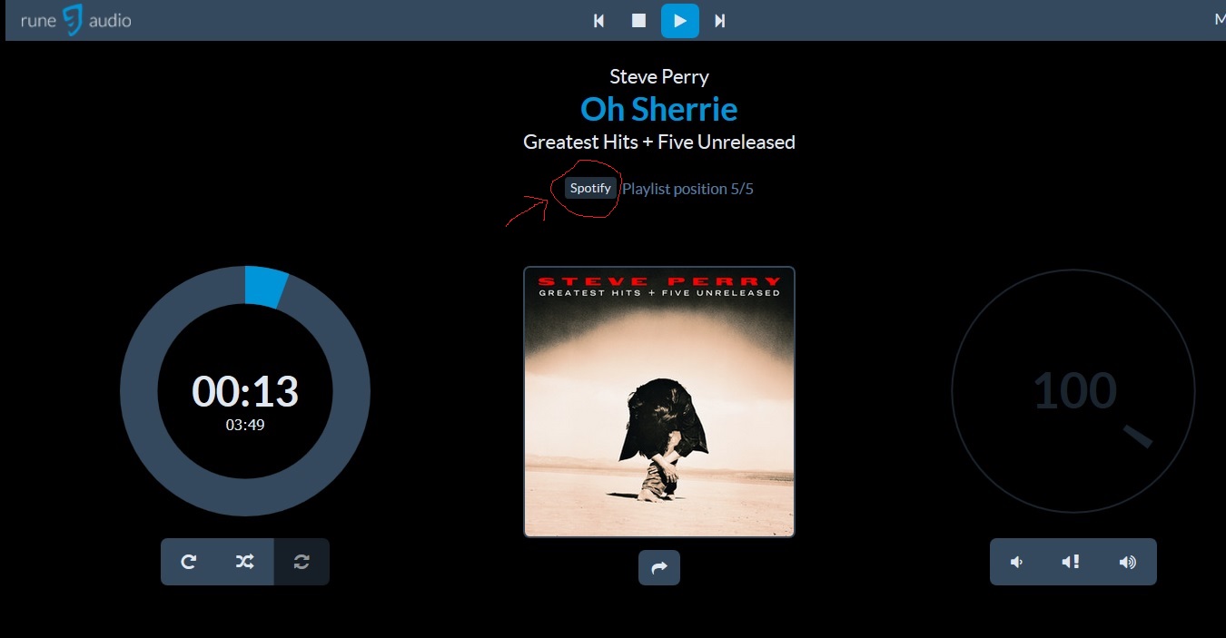

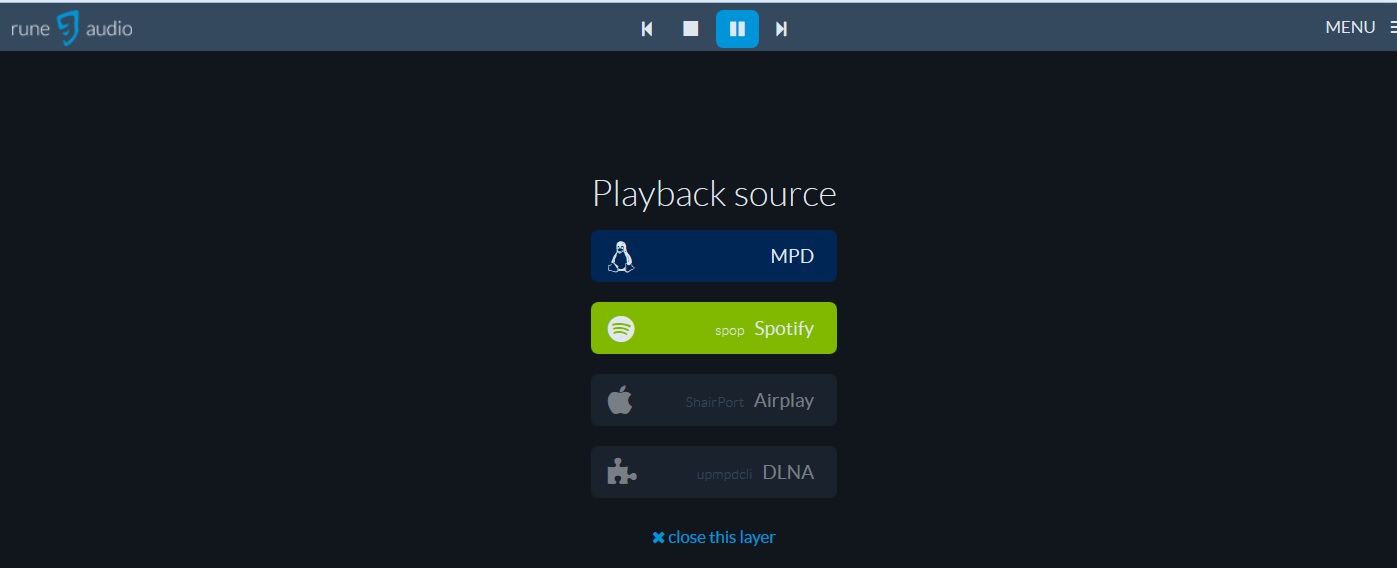

you have to switch back to MPD.
First click on spotify:
then select mpd
