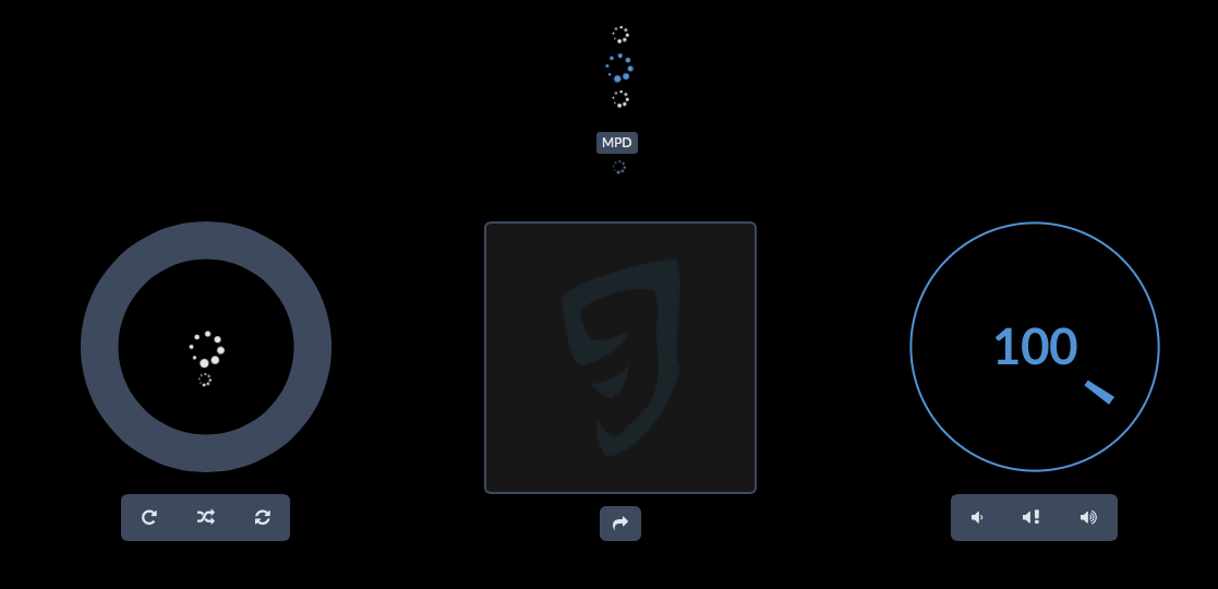

I am using the Raspi 2 image that is mentioned in this thread. It works great, but shows a minor glitch on my system: After I finish to "airplay" to the Pi, I have to reboot it in order to get back control. The "Playback* GUI is locked up otherwise:
Bildschirmfoto 2015-04-10 um 18.17.40.png (51.29 KiB) Viewed 3444 times
Is this a known issue with the 0.3 "+" beta?
Thanks! Martin
