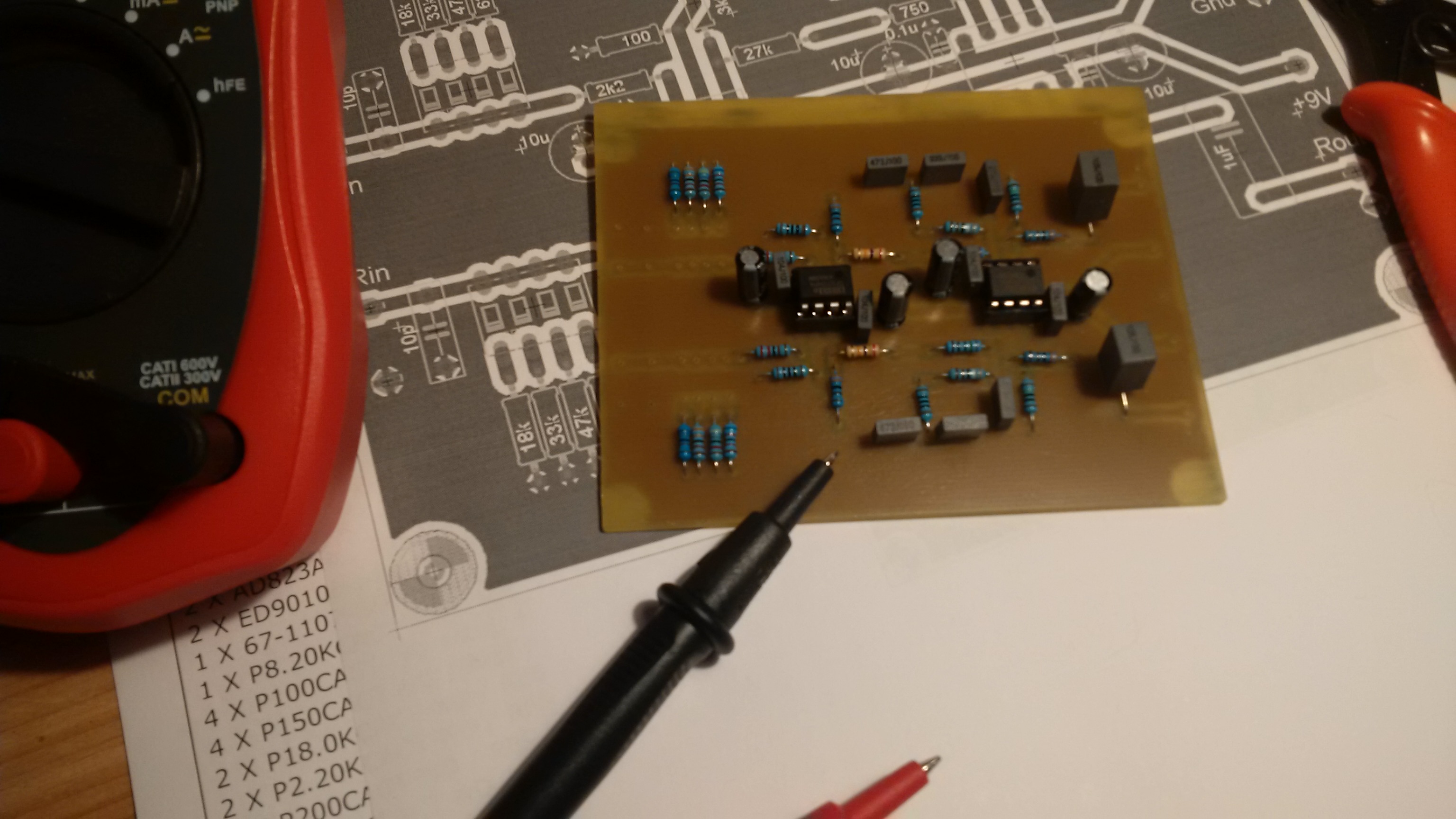

Rod Elliot, P88 (http://sound.westhost.com/project88.htm)
CNC Phono Preamp (http://www.audiokarma.org/forums/showthread.php?t=371889)
