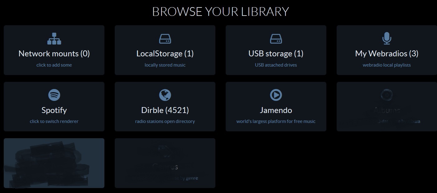

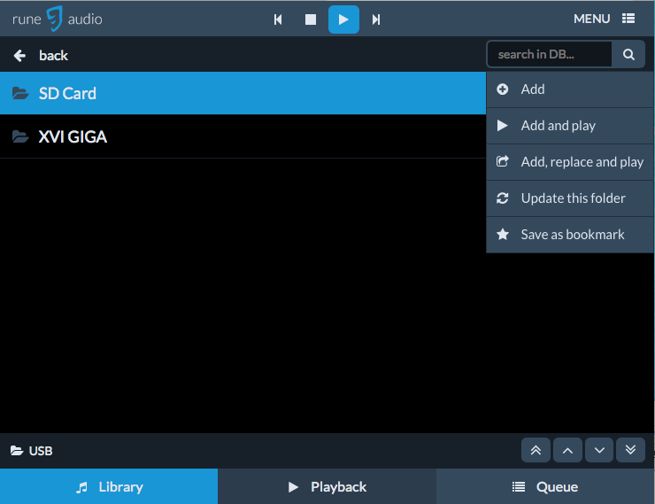

Postby davidemania » 15 Dec 2014, 11:15
Schermata 2014-12-15 alle 11.11.43.png (44.8 KiB) Viewed 9800 times

Postby ACX » 15 Dec 2014, 13:34
Thank you for reporting the detailed steps you followed, which could be useful for future readers.
