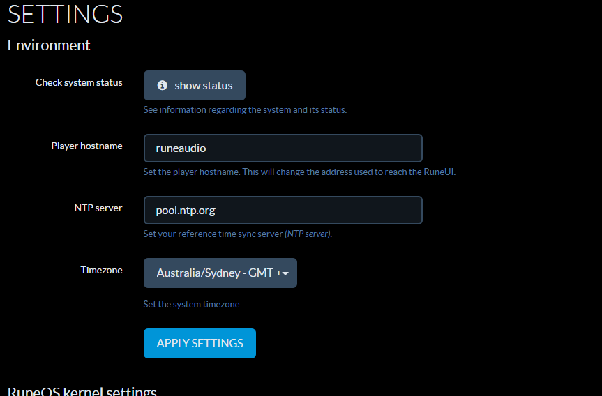

Postby foxint » 16 Apr 2016, 22:52
Hi Frank
It was about updating and the date....I did the usual installed the software a number of times and things seem to get better.
I think it may have sorted itself.. the date/time is Sat Apri 16 21:59;25 UTC 2016....that is not the time here....but better than it was. Previously it was showing Feb 22.
I hope this is Ok to jsut leave?? Is there an automatic updater, or do I have to write the 3 line code?
Just asking....the music is great....the sound excellent - thank you for making it.
D

Postby foxint » 16 Apr 2016, 23:00
Hi Frank
I have...Australia/Sydney - GMT+10....it is Sunday 17th 8:08
