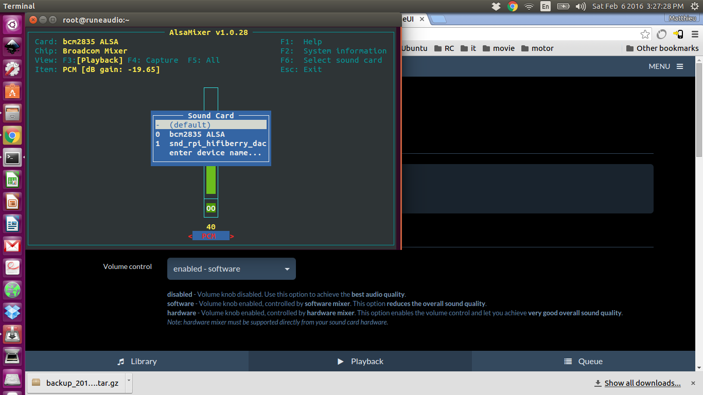

just figured what you might mean with the alsamixer part.
ssh into the pi. -> alsamixer and than i saw this
Screenshot from 2016-02-06 15-23-03.png (150.36 KiB) Viewed 4014 times

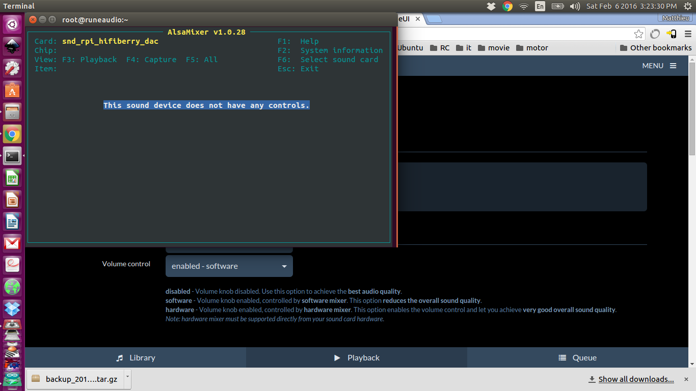

figure changing the card would be an option.. so
Screenshot from 2016-02-06 15-27-28.png (160.38 KiB) Viewed 4014 times
selected the hifiberry:
Screenshot from 2016-02-06 15-23-30.png (151.24 KiB) Viewed 4014 times
which would be oke, because the intend is to regulated via the z10
but once i exit. and enter again it is back into the alsamixer.
is this the problem? a problem, but not the problem, or is that no issue?
greetz Matt

sorry the Hifiberry DAC does not have any volume controls in alsamixer (i forgot about that).
Your problem is strange, because software volume control at 100% should be the same as disabled volume control.
