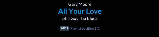

If I play a song from my Hdd this will show:
Album title and song title separated in two lines.

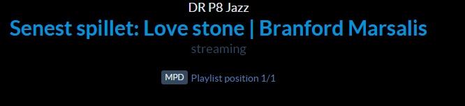

From WebRadio this:
Album title and song title at same line
Could it be possible to separate the album title from song title when playing WebRadio ?

@Bjarne: that depends entirely on what the radio station puts in the title tag. If you try other stations from Dirble you'll see that they display artist and title correctly.

while I understand the fact that you are unhappy to see the title and author on the same line, divided by the '|' character (and it does look ugly, I agree :)) , my feeling is this is completely up to the web radio station to send feeds in a more readable format.
My understanding is that the split on the ':' character was introduced to circumvent a parsing issue RA had between the backend and frontend whereby any string (Title, Artist, CDTitle) passed to the UI which resulted in truncating any sub-string following the ':' character.
My vote is that introducing new rules on how the strings are parsed and shown in the UI would overcomplicate the whole thing and also introduce a case for other users to be unhappy with the solution or to ask for additional delimiters to be used, which would make the thing unmanageable.
Maybe it would be easier and safer to provide your feedback to the web radio station, telling that using the '|' character to separate between the title track and the artist does not look good - maybe using a simple char like '-' would be visually more enticing.
This is - of couse - my own view - I'll let the RA devs to comment on the issue.

@Bjarne: do you want to change that behaviour only for a specific web radio or this happens with many of them?
In the first case you could edit the code introduce a dirty but working piece of code that will check the match and output a custom text when that specific radio is played...
