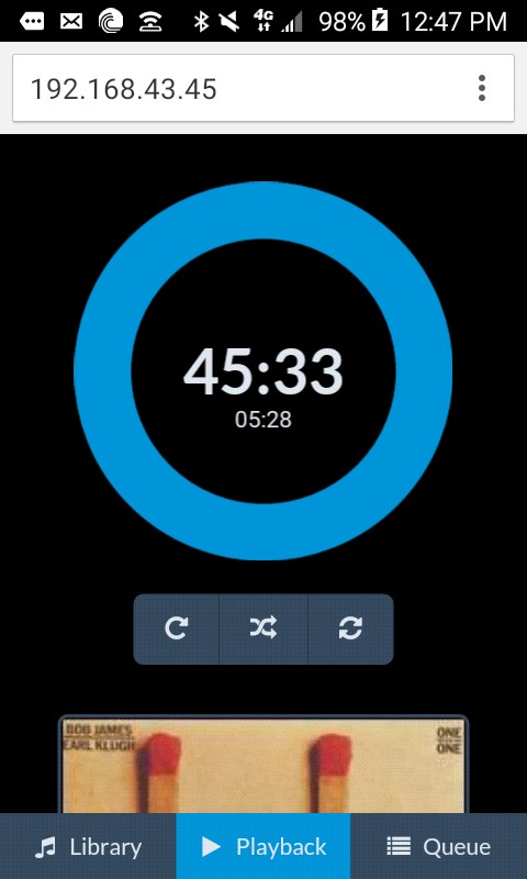

This may be related to previous posts discussion about what happens when the web UI loses connection with the player.
For Example:
In this case the web UI on my not-so-smart phone continues to work, and so does the player. There is no indication of losing the connection, or a spinning circle.
However, the Playback screen shows the previous (completed) track and the track time continues to advance past the normal end of the track. I can select and play a new selection from the library screen, but the Play screen does not change and still shows the old track. The Queue screen is locked up (unresponsive).
Typical Play screen, showing 45 minutes elapsed, on a 5:28 track length:

The screen cap was while streaming music from the laptop (Ubuntu 14.04), via the phone/hotspot (Android 5.1.1.) to the Pi(Rune Audio, HiFiBerry DAC+). Similar thing happens w. local source library though. Chrome on the "smart"phone, and I have not tried a different browser.
I think it happens when the Pi has some kind of hiccup, but I am not sure. I think the UI running on the phone does not detect when the connection is lost, like Bubble UpnP does and throws an error, but there is no easy way to verify this.
I can actually select and play a new track from the library when this happens, but the Playback and Queue screens will not show it. So the Rune UI CAN communicate with the Pi, but not all parts of the UI seem to know it. I am not sure how this squares with the socket theory etc.
