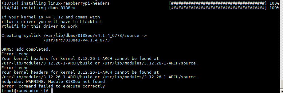

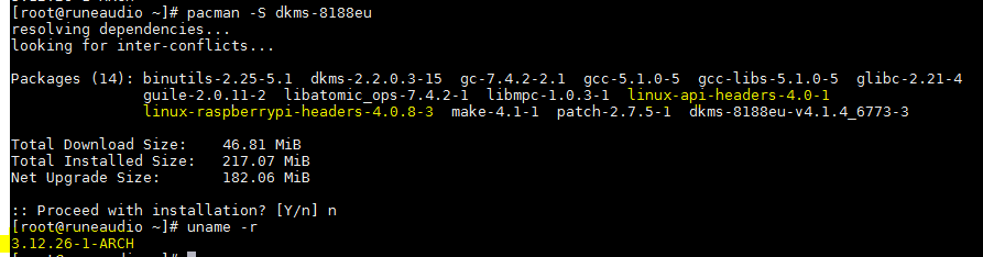

Postby afick » 17 Jul 2015, 23:15
repo2
repo
